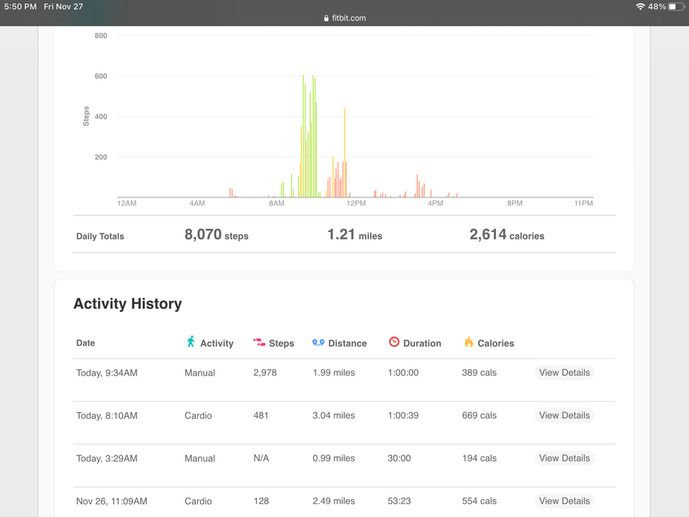

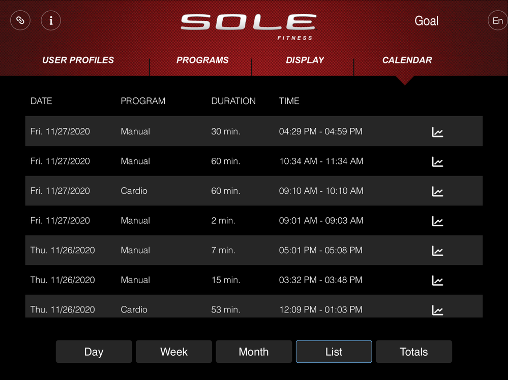

I have a new SOLE treadmill that records data in an app on my iPad. When sent to my Fitbit app, the activity is logged in my detailed activity list but has the wrong time stamp and the activity is not included in my daily totals.
I am running the latest version of iOS, both apps and my versa 2 watch.
At the end of the workout, I select the workout in my treadmill app and « send » it to my Fitbit app that is also on my iPad.
The interface from the 3rd party app worked because I can see the activities were added to my Fitbit detailed activity log.

Hi Liliya, thank you for reaching out to me. Actually, the customer support person I spoke with was extremely unhelpful. She told me to contact the treadmill vendor because it's probably their fault. As an IT professional, I have to say that response makes no sense because:
1 - I see that in February, others reported similar problems with manually entered activity that ended up with the wrong timestamp and didn't update the totals.
2 - The 3rd party's responsibility is to feed the detailed information, which it did, because I see the activity in my detailed Fitbit activity report. The Fitbit app would take the detailed information received and update the totals.
So far, I have not received any follow-up or sign of life from customer support so I would appreciate your continued help in this matter. SOLE is a major manufacturer of exercise equipment so I think it's important for Fitbit to help work out any problems with the interfaces.

The detailed activity was uploaded correctly except for the timestamp. The duration, distance and date are all correct. The data in the SOLE treadmill and the treadmill app have the correct timestamp and correct time zone. My phone, fitbit and fitbit app also have the correct timezone settings which are the same as the treadmill.
I would agree that the treadmill app probably uses a standard interface to send the detailed transaction data. The Fitbit received and processed the activity data because I see the activities in my fitbit activity list. As you would know as an IT guy, the process that receives the transactional data on the Fitbit side is responsible for taking the data received and updating everywhere in the Fitbit system that needs to be updated... including totals, dashboards etc. As you said - "update the totals when accepting the exercise record".
If the SOLE interface is sending data that fitbit is unable to process correctly, I would expect to receive some kind of error message from the fitbit app giving me some indication of what the problem is. I could then take that information and correct my settings, or contact SOLE or whatever is necessary. Unfortunately, I didn't get an error. The fitbit app accepted the transactions and only partially processed them.
Fitbit totals <> sum of details
Treadmill App
I did finally get an email from the customer support team saying that they are investigating the problem so I'll wait to see what they come up with. In the meantime, I'm not using the treadmill interface which is a shame. I'm using the treadmill exercise setting on my fitbit but that doesn't yield accurate results for the distance covered.

Interesting that it appears from the four entries that match that the time is off by exactly one hour for three of the exercises and one of the entries is off by 13 hours. That is the type of information that tech support should be aware of if they are not already.
So off by one hour and not respecting am/pm - another reason that interfaces reporting times should use a 24-hour clock, though that doesn't always guarantee success. Bugs are bugs.
The 'ol one app confused about or not respecting the others timezone or one app is confused about daylight savings or one app or the other or both just "messed up".
