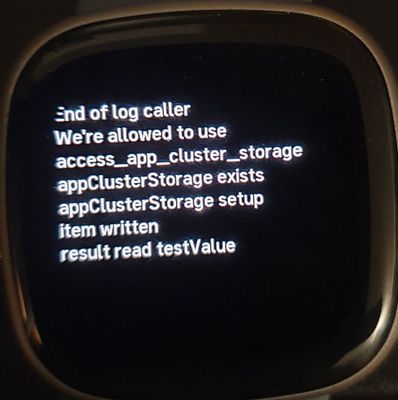

02-13-2024 21:26 - edited 04-22-2024 00:03
Bingo! It works within an App.
This confirms it is on watch storage and no need for the companion and phone storage.
Curiously it causes the simulator to crash the watch, instead of not working.
Thank you, you are a Star!
