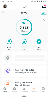

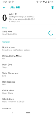

I managed to contact the Live Chat today who sent me details to do a battery drain test. However, it requires you to sync the device 4-5 times a day and I've found out that I can't sync successfully sync my device.
I've followed the troubleshooting steps here, and followed the advice on the forums here, but it still says the last sync was on 25th September (which coincidentally is around the time first noticed the battery drain problem).
But I can still see what activity has been tracked daily on the app and on my dashboard? So I'm not sure what kind of syncing it meant to be going on - whether it is syncing, and the app is bugging out and telling me it isn't. Or whether there's a separate kind of sync that isn't related to how my activities are shown in the app which isn't working.
I've attached 2 screenshots - one that shows the device page where it is perpetually syncing, and the other the dashboard which shows data from today.
Dashboard data seems to be synced?
Perpetually syncing
