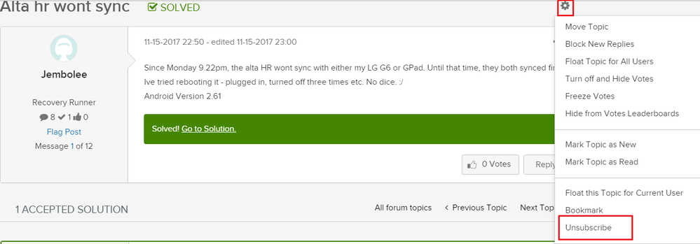

@Jembolee In this case I'm afraid I cannot delete your thread since there are other users who are experiencing the same scenario you were in the past and they still need attention. However I understand you do not want to received more notifications about this topic, so you can unsubscribe from the thread. Go to the small gear icon in the top of the thread and hit Unsubscribe.
