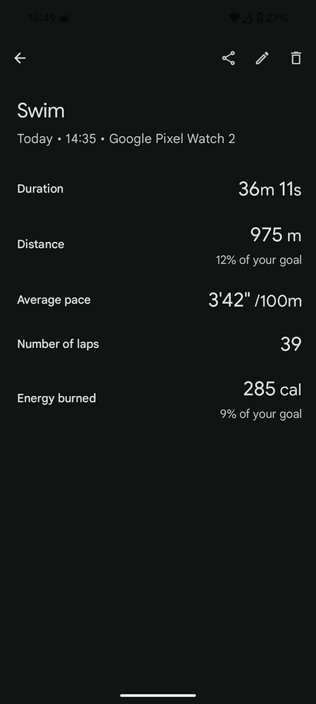

I've set my units to meters on the watch and in the Fitbit app. I've set my pool to be 25 meters. I always start at one end and finish at the same end, so always an even number of lengths. The watch normally picks up the right number of lengths. Today it didn't, so I went in to change it.
Original readings:
Distance: 975 m
Number of laps 39

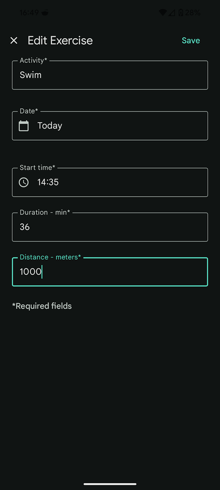

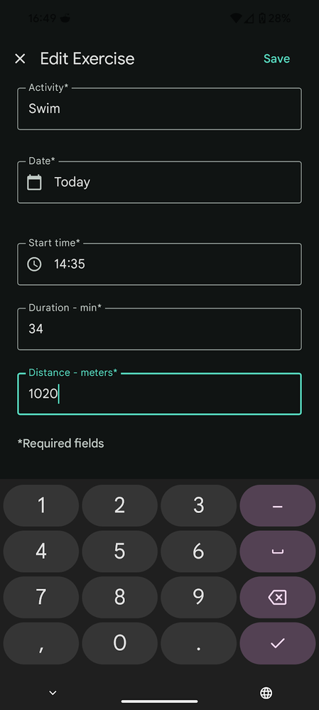

Changed it to 1000 m and pressed save.
New readings:
Distance: 914 m
Number of laps 38
Changed it to 1020 m and pressed save.
New readings:
Distance: 933 m
Number of laps 38

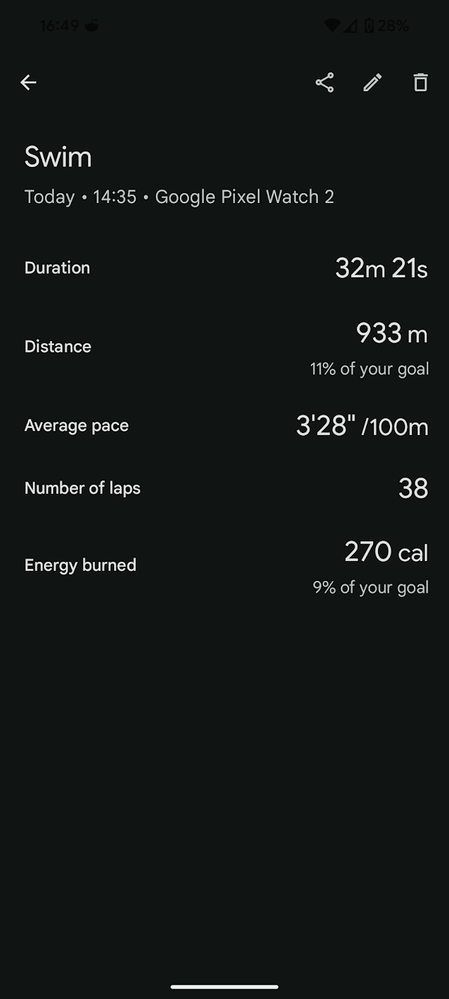

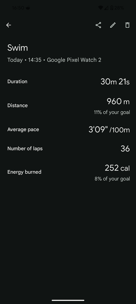

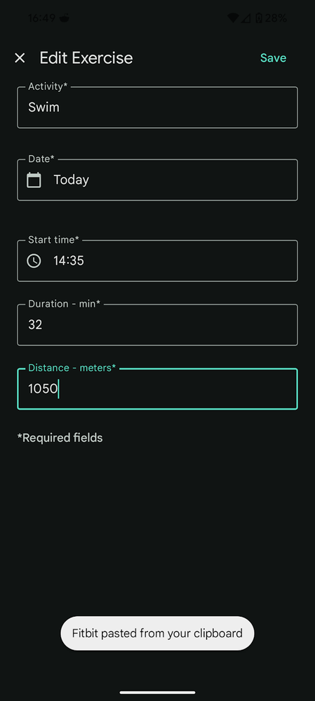

Changed it to 1050 m and pressed save.
New readings:
Distance: 960 m
Number of laps 36
Changed it to 1100 m and pressed save.
New readings:
Distance: 1006 m
Number of laps 34

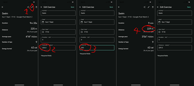

This has happened before, but I didn't capture it. Something is wrong, I suspect it's a conversion between feet and meters, but it's not right, and this was my first 1000 m total swim, and it's messed it up !!!
I suspect it's something to do with YARDS and METERS conversions, but something is messing up when doing it.
There is a strong indication that the bug is a flawed conversion. It appears that the app is taking my input in metres and incorrectly applying a yards-to-metres conversion factor (1 yard ≈0.9144 metres) when it saves the activity. This happens even when my app and watch are set to metres, which makes it a very clear and frustrating software bug.
I contacted support, they asked me lots of questions, recommended I check the hight/weight/gender setting, because that depicts stride, tried to tell me it's all about GPS tracking, and when I redirected them to "laps" in "swimming", they asked me to force close the app, sign out, sign in, asked for the version number, but still no help. Apparently, it's been escalated, but I've not received an email yet.

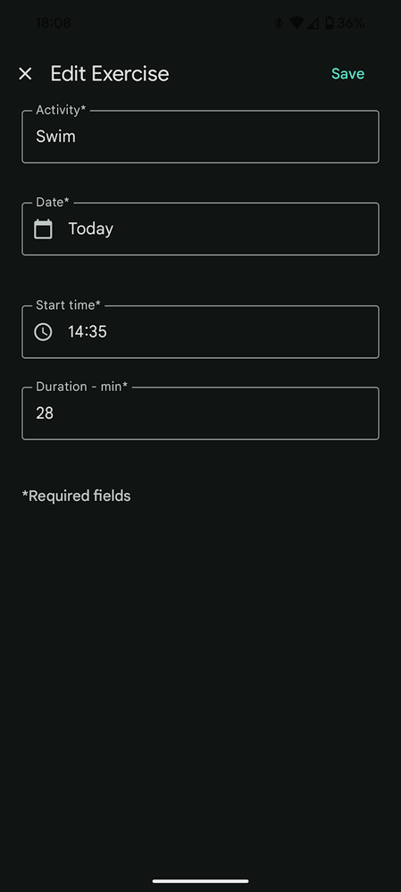

The last screenshot after following the instructions now only allows me to edit the distance. This is awful. Looks like it's been happening for years.
