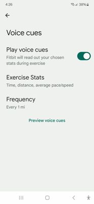

Just figured out I can include a screen shot. Follow my original directions. See screenshot.

When you open that and check Time Distance and Average pace/speed. Still not working? Once we hit save. We hit preview voice cues and got her with a generic stat cue. Then next time we walked it worked has been ever since. Fixed both my husband's and mine.
