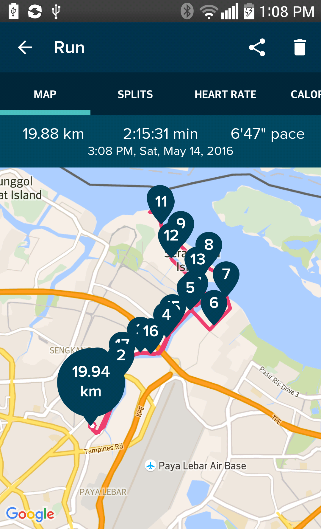

I usually run 20km at a pace of 7 min per km and I use the "Track Exercise" in android app. At the end of the exercise of 20km, the "pause" was not responding and it seems like it always stucked at about 15km. Scrolled to the right-hand side of the screen, I can see the map and the red color path and it was still moving from about 15km. It might take about another 30min for the red color path to reach 20km. Then I could pause/finish the exercise. It showed me the correct path and split except the very last km. In many cases I could sync back to Fitbit server but in few cases it could not.

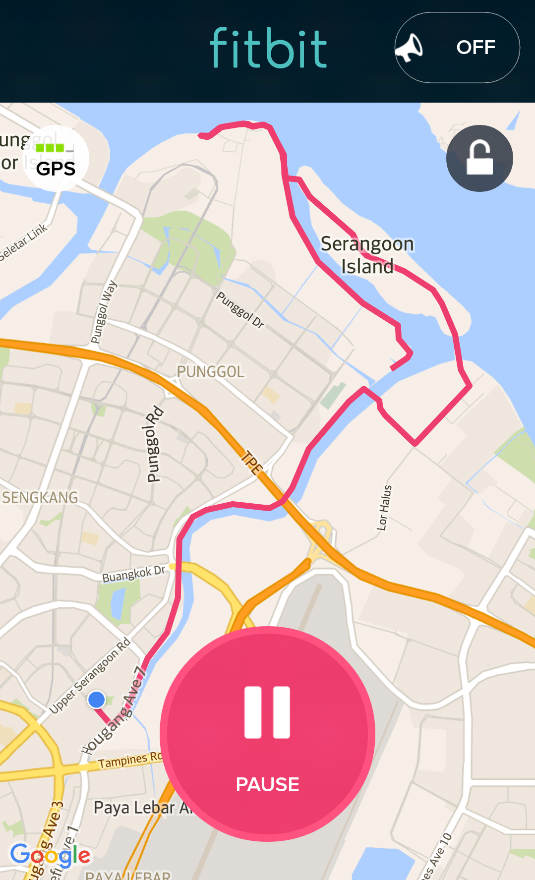

This was a run before the app updates on 16 May 2016. Everything seemed correct except I had to wait 30 min before I could pause/finish the exercise. Of couse this would affect the "splits" in the last km and also total time.

Thanks for the screenshot @KelvinNg and yeah test it and let me know if the issue persist. In the meantime I'll try to investigate more about this issue, because is the first time I hear about this. Lets hope this bug get fixed with the new update. Smiley Wink

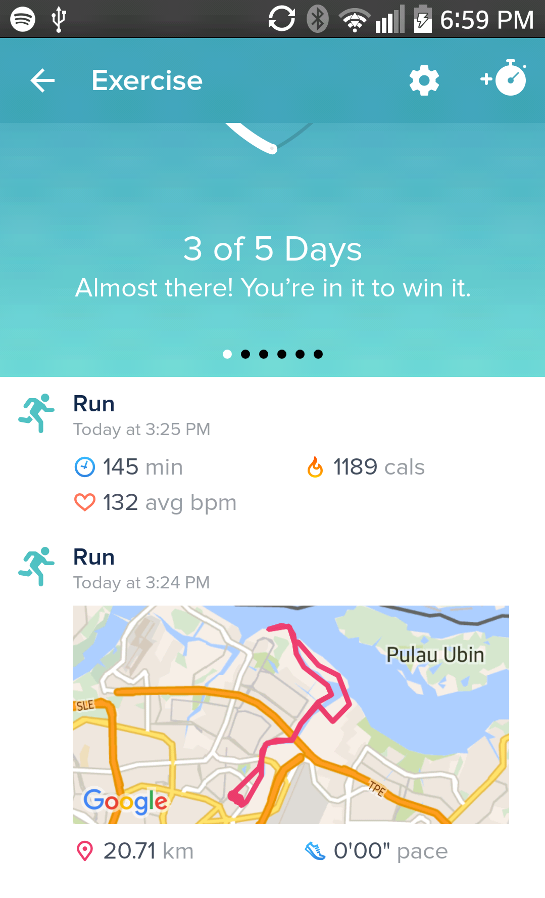

After the app updates on 16 May 2016, it is even worse now. Went for my usual 20km run. As you can see from below snapshot, the blue dot shows the GPS position where I completed my run. The red path still at 13km location and it took 1 hr to "catch up" my run then I could click "finish". After 1 min or so then it crashed. This run was not able to sync back to fitbit.com. I ended having 2 entries in my app - 1 entry using "track exercise" in the app, and 1 entry was automatically detected.
