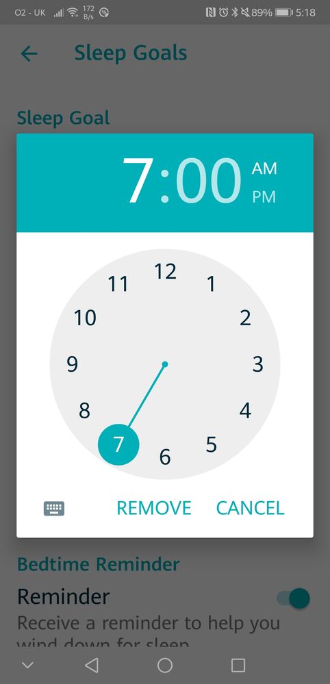

I'm trying to set my sleep and wake times and the only options I get when opening the clock to set them are remove or cancel, there is no done or OK option, any help? I'm on android, huawei p20 pro if that helps at all.

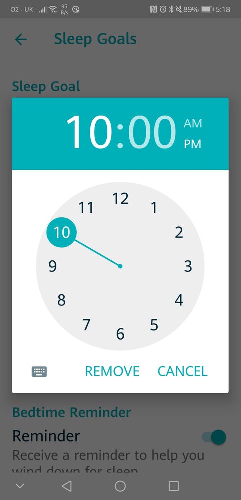

Thank you for your reply @LanuzaFitbit, these are screenshots of my sleep options, and then what happens when I try to set a sleep time or wake time, the clocks pop up but only allow me to cancel or remove

Have you tried to set the correct time and then tap the 'Back' button on your screen and see if the goal saves at that point.

@LanuzaFitbit, yes I have tried setting the time then using the back button but this also does not set the time. Will I be needing to contact fitbit directly as I can't seem to find contact details (I am in the UK if that makes any difference)

Let's try going into the phone's setting and reducing the size of the text. That should help so that the option shows completely.

YEA! Changing the font size actually works! Originally every time I tried to change my sleep setting the only Fitbit app options were were - Remove or Cancel... HOWEVER.. once I "reduced" the font size in the display settings of my android I now see: Remove - Cancel - OK (it seems when a larger font is selected the OK option gets moved or pushed off to the right of the display where it can't be seen or selected. NET: A poor Fitbit app design
