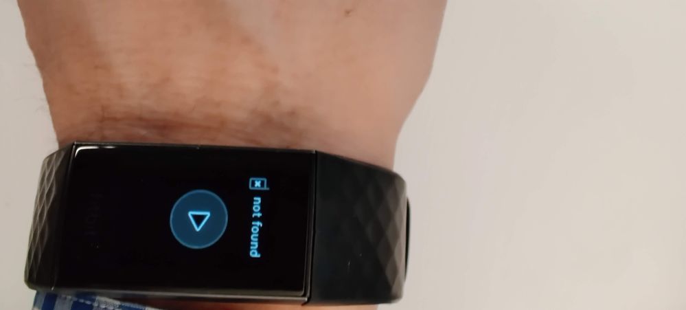

My Fitbit Charge 3 encounters an error where it will not connect with the Android app for GPS tracking after going into and coming out of Airplane mode
This happens 100% of the time, despite the fact that, when out of Airplane mode, Bluetooth is on (and shows Charge 3 'currently connected'), the app is running, the app syncs correctly and the app notification on Android says 'Connected GPS is running'. The GPS connection in fact fails and it is impossible to connect the GPS.
The GPS connection will fail until you either Force Stop the Fitbit app and restart it or reboot the phone.
Error shown on Charge 3: Phone not found. Launch Fitbit app.
Charge 3 Firmware version 28.20001.63.5
Android version: 10 (OnePlus 7T running Oxygen OS 10.0.6.HD65AA

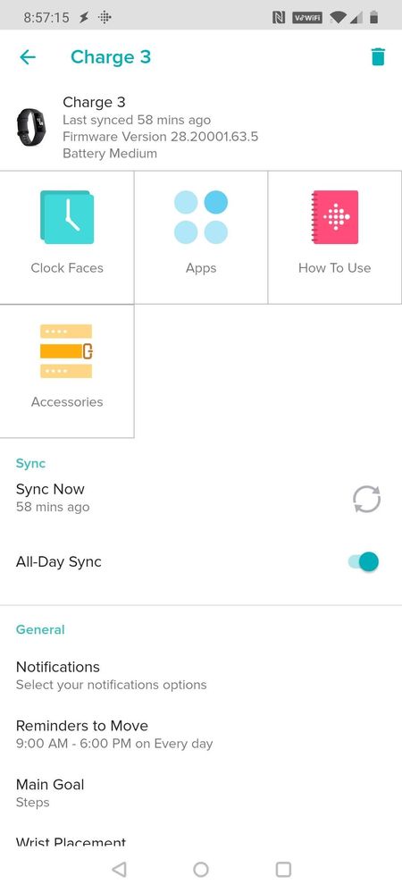

LizzyFitbit,
This is a bug in a supported device! Please stop suggesting things like 'checking if the phone is in power saving mode'! It is not. Instead, please let me know where I can file a bug report. Or even better, proactively file a bug report yourself.
To help you, I have attached three screen shots along with brief descriptions.
As a Fitbit moderator, you must have a way to get bug reports back to the dev team. As I look through these forums, I see a very large number of Bluetooth issues being reported with very little response by Fitbit that the issues are being addressed. Here is an opportunity to report back a bug to the team so Bluetooth can be made more reliable for the next release.
I really look forward to hearing back from you about how you will report this bug back to the team (or how you would like me to report it)!
Many thanks,
-Mark
First error message shown when trying to connect GPS
Next message shown after about 15 seconds. The Fitbit app is running and was always running.

The Fitbit app will not sync with the Charge 3 device. Force stopping the Fitbit app and restarting it fixes the issue.
