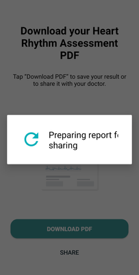

Both the 'Download ECG' and 'Share ECG' options get stuck on the "Preparing your ECG" popup which just hangs there forever.

Hello @IAMSick
Did the issue with the ECG pdfs start after you updated your Fitbit app? Please let us know what app version you have.
Are you seeing the same problem as @Flybit , the app gets stuck at "Preparing your ECG"?

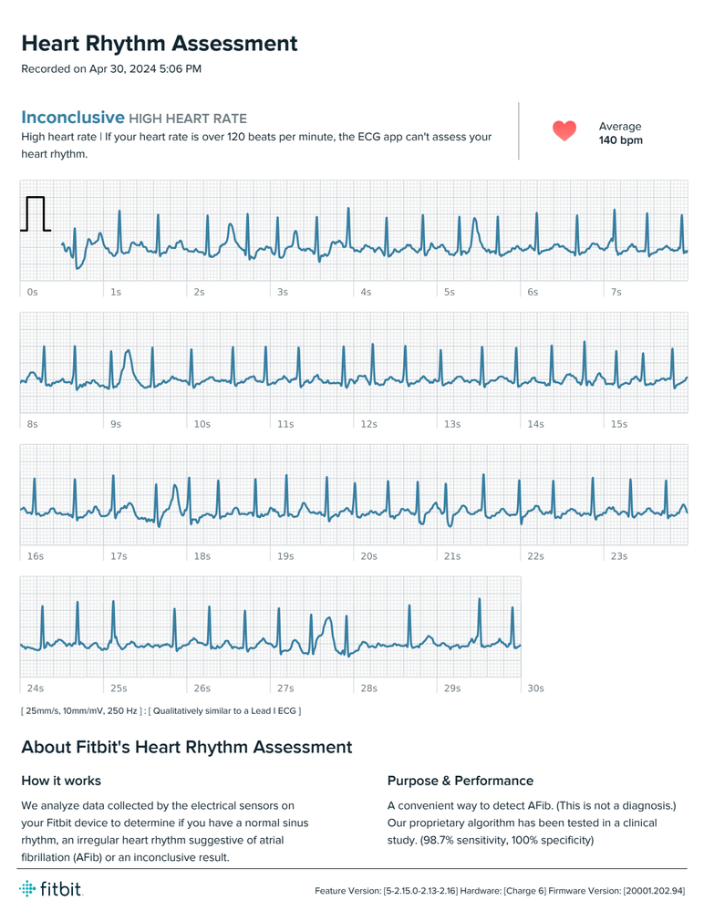

Actually @EdmundC, as someone with hospital-confirmed arrhythmia, my doctor said she was impressed by the quality of the ECGs I've provided her using my Charge 6 device.
Here's one captured during arrhythmia:

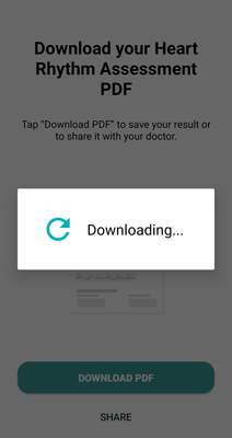

Same sticking point for me. It had been downloading fine on my charge 6 until a couple of days ago
Exactly the same problem as you describe...
"When I try the "export PDF for your provider" option from the list of ECG
reports a window pops up that says downloading PDF with a "got it" button
on the bottom. Before this problem normally I would get a push notification
within seconds and able to download the PDF report. Now the push
notification never shows up and no files are appearing in any of my
Best Answer10-13-2024 20:27
10-13-2024 20:27

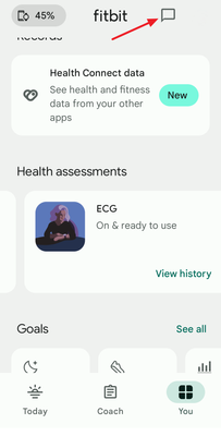

Buonasera @65920692
By the little square box I assume you mean the notification bubble?
I tried that and it does show me notifications about my ECG PDFs being ready, but when I follow your instructions I get right back to the same problem, it stays stuck on the screens below.
However your post did remind me that final PDF downloads came in through push notifications and this is what seems to be broken since the last app update.

Thanks a lot for sharing. This works!!
"...in the new Fitbit app I clicked on the square box in the Today tab. These are notifications and messages. In the Notifications tab I could see a whole list of "your heart rate assessment pdf is ready to view". After clicking the link I was presented with a prompt to view.
Once this process was completed, push notifications started working when I downloaded additional ECG PDFs"
