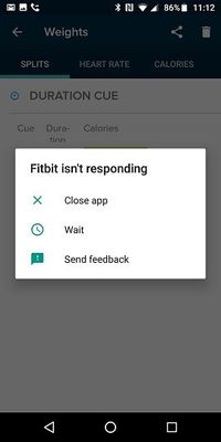

I keep getting "Fitbit isn't responding" messages. I've used the "Send feedback" option many times, but what can I do to stop this happening?

Yes, Android app. I've already tried removing the app, restarting, re-pairing, etc. It typically happens when I click on the EXERCISE icon (the one that says 5 of 5 Days - Goal Met) to view my exercise log, and has been happening since the 2nd day of ownership.
Maybe this is connected with the other problem I'm getting with duplicate and triplicate entries in exercises? http://community.fitbit.com/t5/Charge-3/Exercise-lap-duration-cues-duplicated/m-p/3302754

I've found that I can prevent this "isn't responding" messages by deleting any exercise session has logged multiple occurences of DURATION CUES. So if Fitbit can fix that problem then hopefully I'll stop getting these "isn't responding" messages. How can I find out if Fitbit are working on a solution to these bugs? At the moment I'm having to delete most exercises I do 😞
