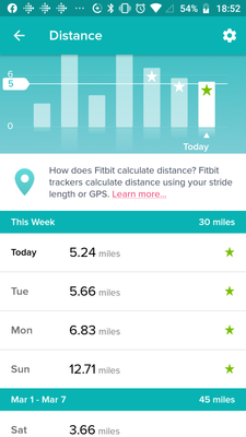

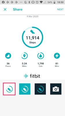

My daily distance goal is 5 miles.  I went to update my activity goals and see it was on my dash as 3.11 mike's.  Odd, so I changed it back to 5 miles. However I noticed that when I had reached 5.2 miles... I was still a long way from green .
From what I can see, Fitbir seems to assume that my 5 miles is 5k (and has lowered my miles), but it is still calculating it on miles and not km
I took SS when the front showed not green miles, bur the weekly dash DID. Then the weekly dash changed to 3.2 miles (nor green). Very confusing.
