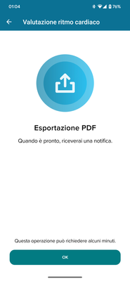

As in the title. I can go up to the ECG section of the app under "you". I find the measurements. Whatever the entry selected, when the "export pdf" is selected nothing happens. No notifications, no downloads, nothing at all.
Clearing cache, uninstalling and reinstalling the app.. Nothing works.

  8. whatever measurement i choose, the result is the same: when I ask for the pdf I got the screenshot I've already attached, and no matter how long I wait, I got NO NOTIFICATIONS, NO EMAILS, and NO PDF FILE pops out on the storage of the pixel 7 pro.

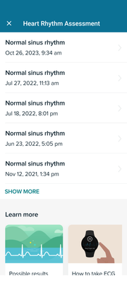

Hi, @kaliaragorn & @RiekoC I'm using a PW2 watch & Pixel 8 Pro in English. I have Premium. I created this ECG some days ago -
At this point you can either download or share the PDF, I choose to share & email it to myself at which point I can view the full PDF.
Your problem may be rooted in the language you are operating with (try changing it to English) or it may be something else.

unfortunately, this is not how it works for me: IT DOES NOT WORK AT ALL.
please find here a couple of screenshots and a video:
I've tried changing the system language to English, thus having the fitbit app with a English UI, but this did not make any difference.

some screenshots/videos:
I could be described as a non-unexperienced android/wearable user. Really never experienced something like that...... I'm baffled... 😭🙈😭
