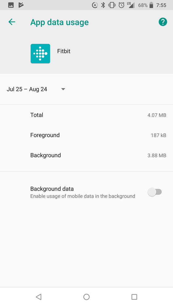

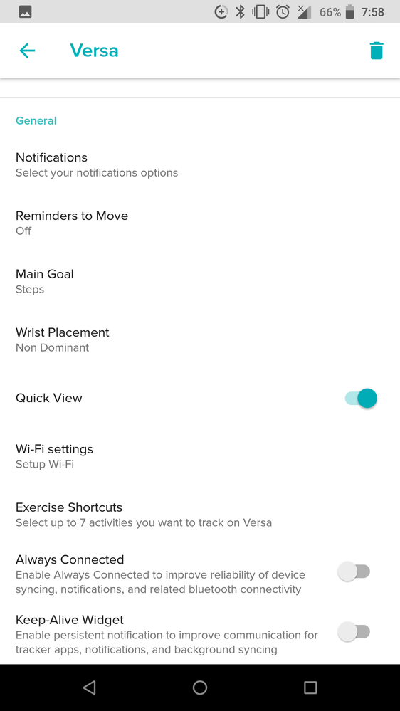

I'm using the beta app but I'm still experiencing the issue. Here are some screenshots (note they are in reverse order, check the time). Again it's not as much as before but it should be using 0B of data given that it shouldnt be doing *anything* in the background.. can you explain what it is doing on my data when it's restricted?
Despite everything turned off, data still being used

I'm not the OP but that doesn't really answer the question, because I'm wondering the same thing.
The question is not "why does Fitbit run in the background?"; the question is "why is Fibit using mobile data in the background when background data is restricted on the phone?"
I've noticed that even with background data restricted on the phone, all-day sync off, and not even opening the app to sync, the app will pull 5-8MB or so of background data per day. Over a billing cycle that's 150-240 MB or so, which is a lot on a 2GB data plan.
Now, I have a rooted phone, and I installed a firewall program back during the "massive data use" bug. I have firewalled Fitbit so that it can't use mobile data. By doing so, I can't sync, log food, etc. when not on wifi, but the connected GPS still works and I still get notifications (texts, etc). And it's not eating up my limited data amounts.
In short, the problem is that the app is using data even when it's not actively syncing. And that's a problem when the phone OS is trying to restrict its data use.
