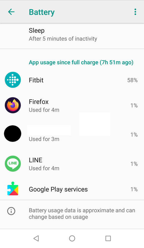

If the former, its the battery usage of the Fitbit App you need check on the phone, not the battery level of the phone. You need to go to the phone settings and have a look at what the OS is saying is used by the Fitbit App specifically.
It will be able to show you how it compares with other apps too.

The same thing has been happening to me. The fitbit app just starts itself even when I don't open it and don't have Bluetooth turned on.
I had just charged my phone before going to sleep, the following screenshots were taken after I woke up.
