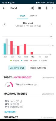

Sunday calories in is off on the graph, the numbers in the other screenshot are accurate
All last week also the graph was inaccurate but then on Sunday everything balanced out accurately for last week but Sunday is not showing correctly
Ideas?

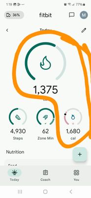

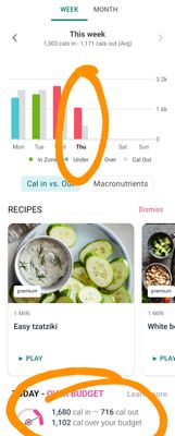

I think I'm having the same problem. The calories out on the food tile are not updating. See the orange circled areas on the screenshots below. I do have my nutrition plan set at a -250 deficit, but this still does not make sense. Is this the same problem as you are having? Did your problem resolve?
I have tried manually syncing, forcing stop on the app, restarting my phone and watch. None of those options worked. I uninstalled and re-installed the app on my phone. This solved the problem for the past two days, but when I started to log food after re-installing the problem started again.
I'm so very frustrated with FitBit. In addition to this I have had problems syncing with Peloton work outs. I stopped using the heart rate function for my workouts. I've loved Fitbit for years, but it seems like it might be time to try something else. So disappointed!

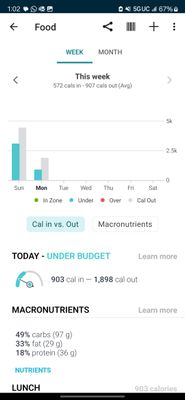

Yes the graph inconsistencies are the same as you are describing
This week mine has been getting worse... not even tracking the out calories anymore on the graph
