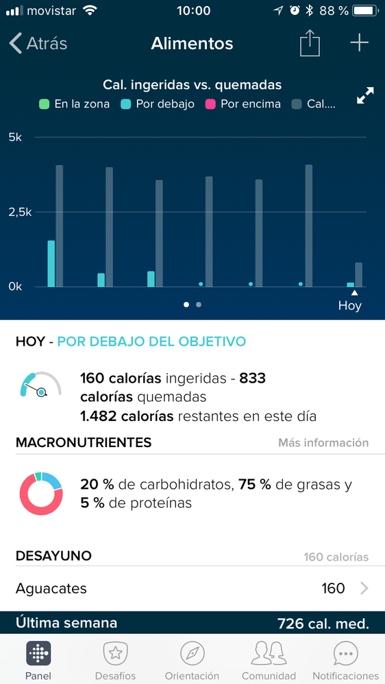

Hi, I’ve been using the versa and the Fitbit app for some months now, and I find the food logging feature a little weird. Though it seems to work for calories, macro distribution is shown in percentage but I really doubt it’s accurate to the real amount of macros eaten, I’ve read somewhere else that this is the distribution of the calorie that this macro brought in your diet. So it tells you where your calories came from rather than how much you ate from one or other macro. I’d really need to now the real distribution of macros eaten (the weight percentage eaten of that macro) rather than the percentage of energy obtained from that macro.

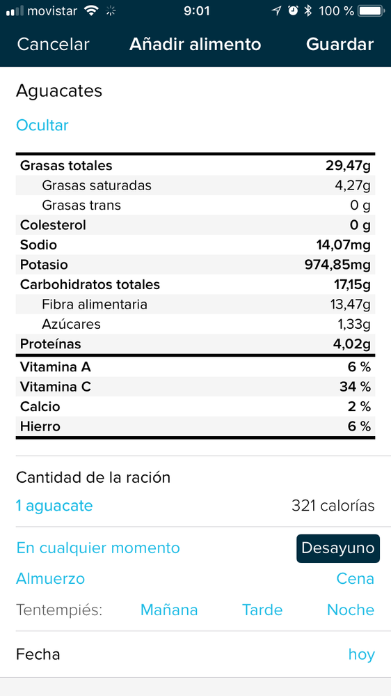

Ok Lanuza, let’s do the simple math. For this exercise we’ll take avocado as an example. The macros for 100gr are:
- 29,47gr fat
- 17,5gr carb
- 4,02gr prot
lets say I log just 100gr of avocado for the day, one could say that my macros for the day would be something like 58%fat (29,47/50,99), 34%carb (17,5/50,99), 8% (4,02/50.99) prot, but the Fitbit app it’s showing these other macro distribution: 75% fat, 20% carb, 5% prot.
It seems by this distribution that the app it’s calculating the percentage distribution of where the calorie came from:
Lets sum all the calories, 29,47 x 9cal + 17,5 x 4cal + 4,02 x 4cal = 351cal.
Now, 29,47x9/351 = 75%, 17,5x4/351 = 20%, 4,02x4/352 = 5%
So I don’t know if this is intended behavior or not, but for me is rather useless to know where my calories came from in percentage, I want to know my macros, in grams or by percentage of the total intake not by how much calories came from what, I’ve never seen that before honestly.
