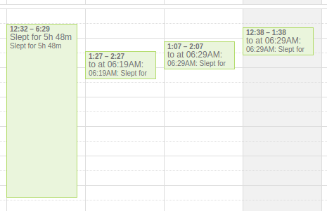

When the system is making the calendar event to show you how long you slept each night on your Google Calendar, it's not correctly publishing the end time as a result, sleep events only last an hour.

I manually fixed the event on the left. The next three haven't been altered.

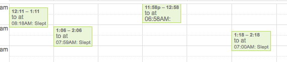

For the last week my sleep has been recorded in two segments, prior to midnight and after. Because of that it now says that I have logged sleep today (7/6) but (in the past) it would have logged it as 7/5. What can I do to 're-set' this clock?

If the tracker recognized any sort of movement during the night and then started to record sleep once again, it wouldn't be possible to automatically have those two integrate on their own. What you can do is to edit the sleep so that it is one long entry. Please try the following steps:

In that case what you can do is to delete both of the entries and then manually enter one for the full time that you were asleep.

The picture posted fine, as I can see it in the thread. I just went into the calendar entry and changed the end time to correct it. That's not really a fix, it's a band aid over the larger problem.

The image still won't load up for me, at all. I agree that it is only a workaround and not really a fix for the situation. Could you try to re-post the image so that I can get a better look? I genuinely can't see the image you posted.
Are you using IFTTT to log the sleep on the Google Calendar?

Bad Entries:
Then a corrected one:
I guess I assumed this was a Fitbit feature. I do use IFTTT recipes for other things so this may be one.

Posting to Google Calendar is not a feature that Fitbit provides. If you are indeed using IFTTT, after some research I did find that this seems to be the happening to a lot of different users. I found a reddit post that proposes a workaround, perhaps you could look into it. That is why I asked if you are doing it through IFTTT.
