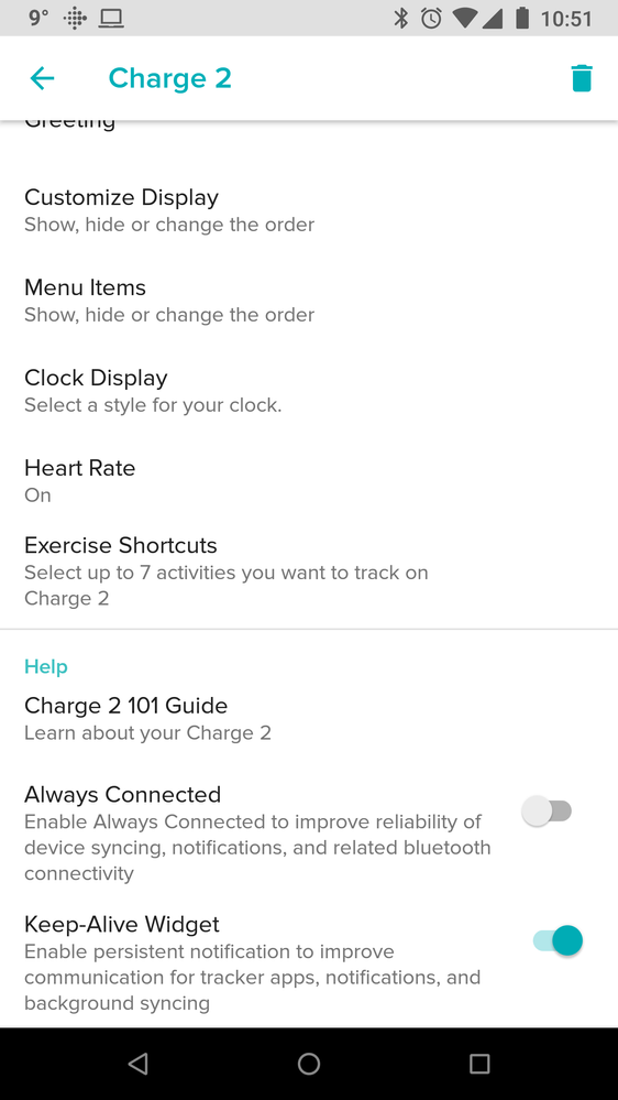

Actually the solution was restarting the phone not the fitbit, maybe it was not clear in my message.
Also I disabled the "Always Connected" option from the app (attached screenshot) and I haven't restarted the phone in two days now. So fingers crossed.
Bye.

Hello @dlopezuy.
Thanks for the clarification and the screen shot.
Hopefully it will continue to work properly from now on.
