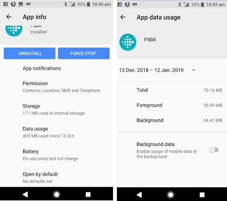

@SunsetRunnerI have always had the settings that @LanuzaFitbit suggested because I want to control my syncing. I use an Ionic and a Fitbit One concurrently.
I have checked my usage, keeping in mind I only open the app when needed because that will always go to the internet. I have averaged 8mb total/day since October 13.. and this month for 9 days it's still 8mb..That's been using App 2.80.1 through to 2.84
I also sync using Fitbit Connect on the PC and home Wi-Fi
Thanks for checking, @Colinm39,
Although your usage is a bit less, 8/day x 30 = 240MB/month would still burn a low-end mobile data contract and the 34MB background data you show should be zero if it is not enabled.
As you are using a different device from me, the problem seems to lie with the app.
@SunsetRunnerThanks for responding. Since we had the Fitbit issue a few weeks ago where it was really churning up the data what you see has been my setting ever since.
Fitbit @LanuzaFitbit need to explain why it occurs when we have the background data option turned off.
@SunsetRunner wrote:Thanks for checking, @Colinm39,

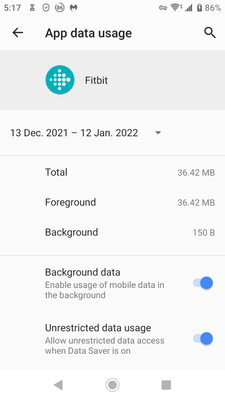

Best AnswerI don't see that option or settings in the Fitbit app you got pictures tell me how to find it cuz I'm looking everywhere and I still don't find it at this rate I might just uninstall the freaking app and never use it again at this rate I might just go to to the unlimited plan
On the Android phone tap
1. Settings
2. Apps and Notifications
3. Fitbit Icon
4. Data usage
5 Turn off Mobile data
