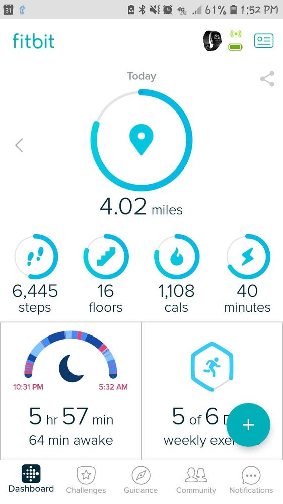

You cant tell me this is normal after you sync. It's never been this off! I ended a walk with 2.34 miles. this is unbelievable
Hello @OhSheeshV.
Thanks for sharing that picture.
In this case, would that be the only walk that you took for the day or have you used the Fitbit through the day? Do keep in mind that it will show the total distance for the day and not for that single walk in that main tile of the Dashboard.
Let me know if there are any further questions.

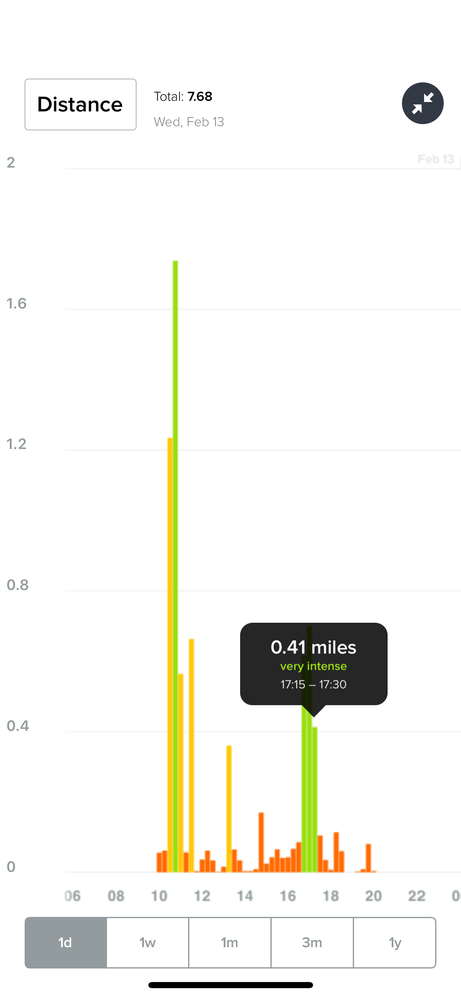

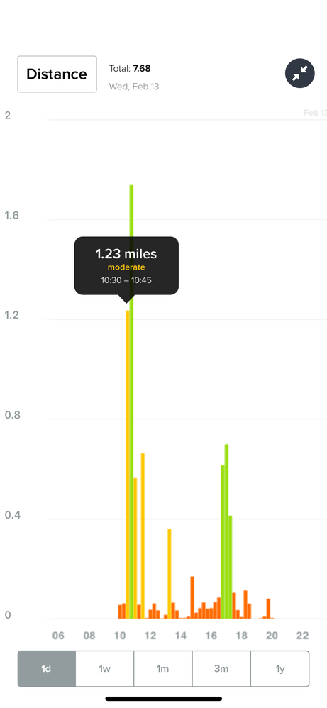

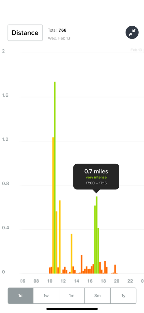

Scenario 1. Yesterday morning, my walk to work. Takes 30 minutes, and it's a 1.5 mile walk. This is what the app recorded in that 30 minutes (2.9 miles).
Scenario 2. Yesterday's walk home. I normally take a slightly longer route, which is 1.7 miles. For some reason, the app saw that correctly:

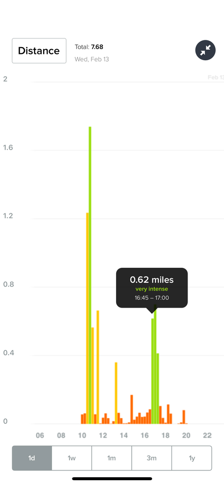

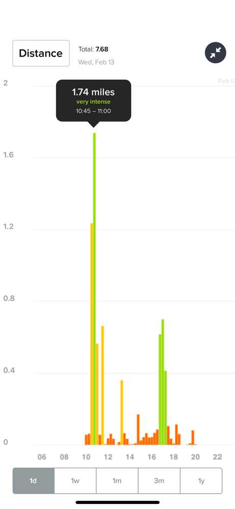

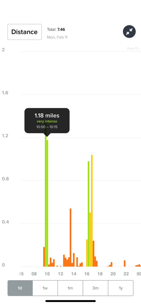

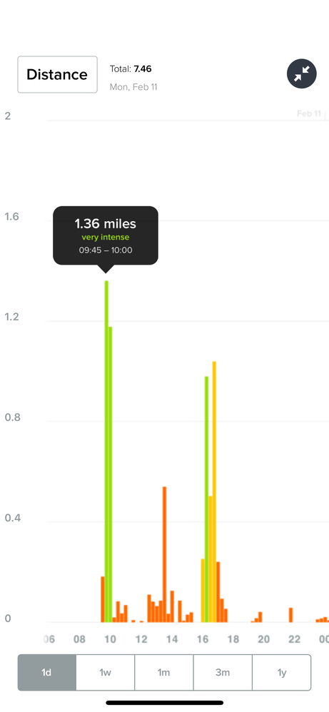

Scenario 3. Walking to work on Monday 2/11. Should be ~1.5 miles, but it's ~2.5...
(And you can see in the other spikes that the walk home also miscalculated)

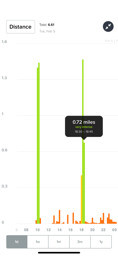

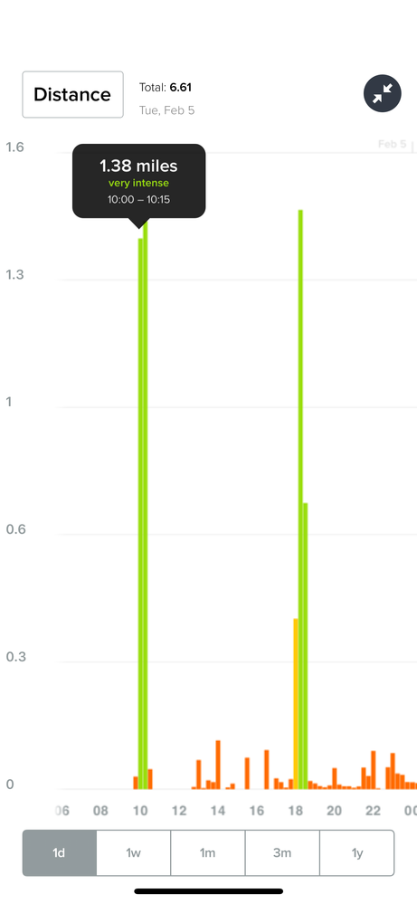

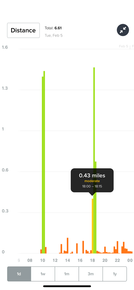

Scenario 4. Walking to work on 2/5. Should be ~1.5. App shows 2.8 miles.
Scenario 5. Walking home on 2/5. Should be ~1.7, but it's 2.6

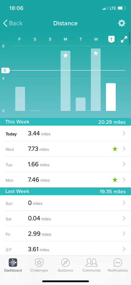

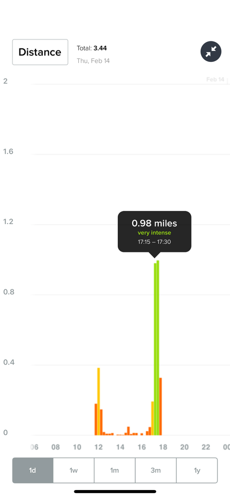

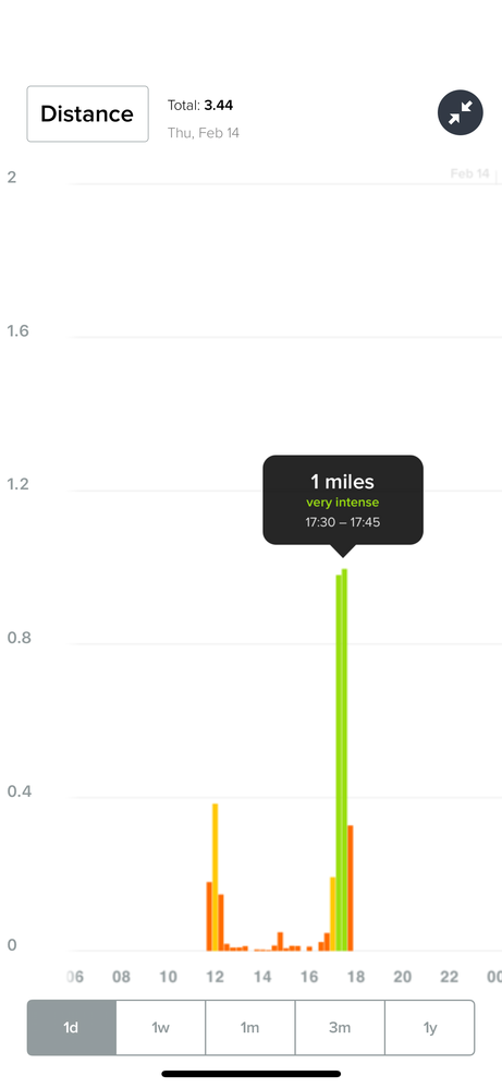

Best AnswerOk, here’s today’s scenario.

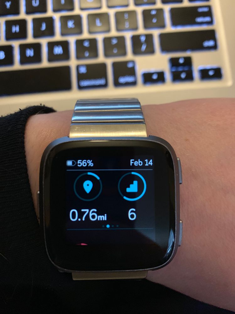

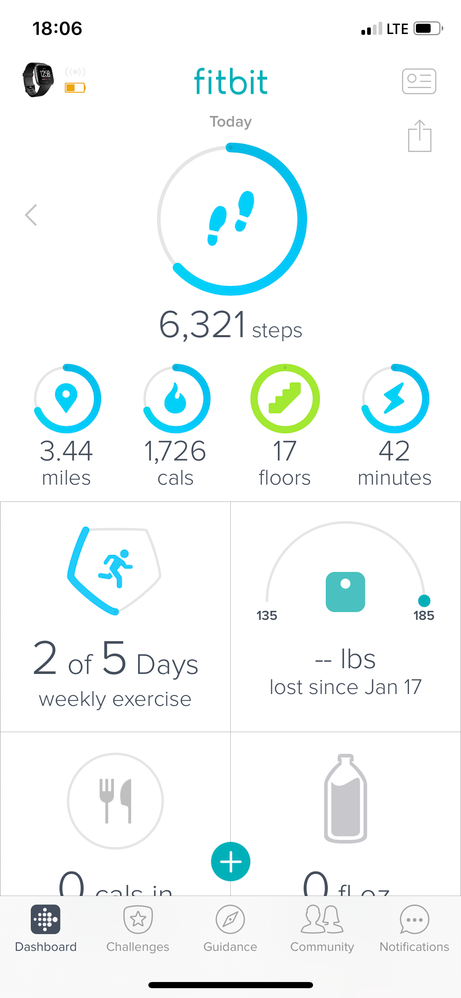

Walked around this morning in spurts, 0.76 miles total. The watch is correct:

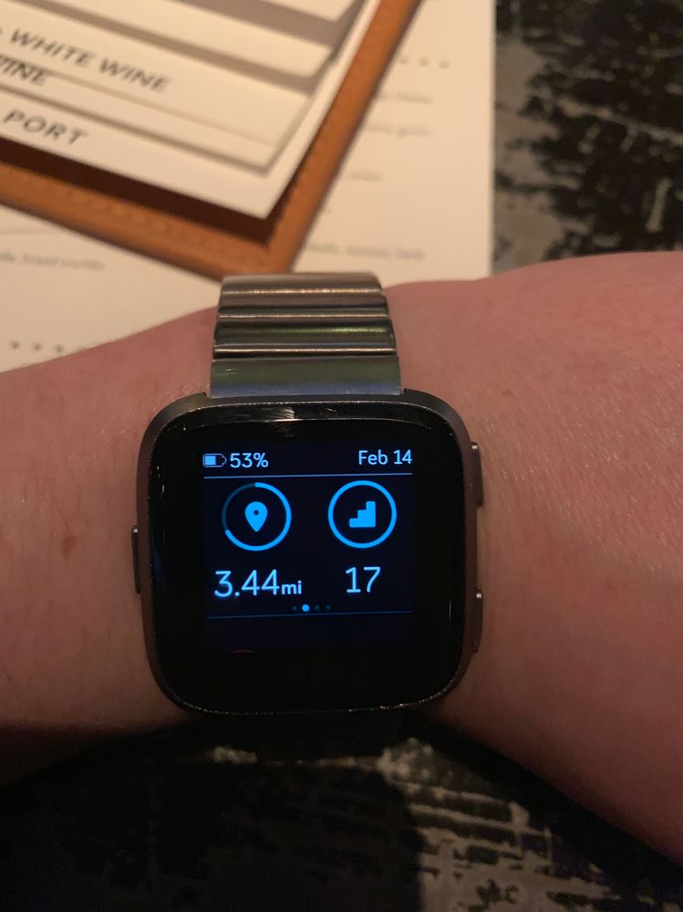

Then a little walking. Nothing major. Then a 1.6 mile walk. Total on my watch was 2.43. Then I synced. 3.44 miles on the app and my watch changes to match. It’s like every time I take a longer walk, the app overcalculates.
