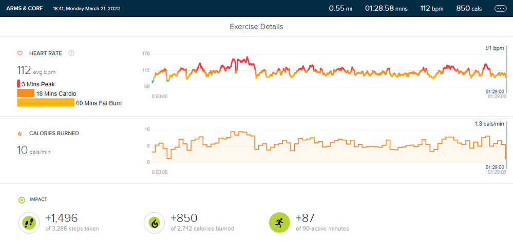

I have no issues with my Charge 4, but I manually start a "Workout"" under my exercise apps, and then rename it later, to the correct workout. This is fro my most recent workout:

My Charge 4 give Zone minutes versus Active minutes, but they should function similarly. I do know that when I tweaked the standard max heart rate from 160 to 165, that was enough to change my minutes quite a bit, since i spend a lot of time at the edge of the two zones. Any chance you have custom heart rate or heart rate zones set up?
