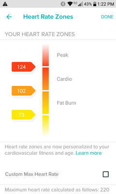

Here's what mine looks like.  I don't see max heart rate anywhere, only the boundaries between fat burn, cardio, and peak.  Does your look different?  If so are on Android or IOS?
Thanks a lot.
It's below the "zones".
I had checked custom heart zone and that's why I was getting a customized max HR of 176.
After u checking the boxes, it's gone to 220-54 =166
Thanks, Mr Row!
Much appreciated
I'm glad you got it figured out.  That 'Custom Max Heart Rate' is just meant for people who somehow know their max heart rate to be different than that determined by the default formula.
