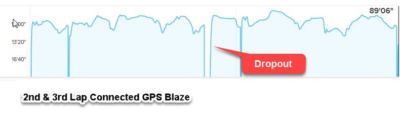

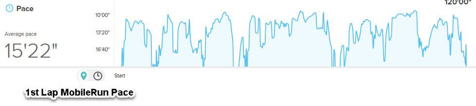

Over the last few weeks I have noticed the Pace graphs in the MobileRun are very erratic. At the same day, not the same time, with the same environment,
Blaze Connected GPS and Surge are stable as per the images.
Has anyone else experienced this,?

I have just completed more tests and the erratic pace graphs persist, but when I run part of the the test with the Blaze and MobileRun recording concurrently the Connected GPS has an acceptable Pace Graph
I kept it simple..I did 3 laps of my walking area
                                         Lap 1                        Lap 2                        Lap 3
                                       I---------------------------I---------------------------I---------------------------I
Surge GPS Laps 1,2,3   I<--------------------------I---------------------------I------------------------->I
MobileRun  Lap 1           <------------------------>I
Connect GPS Blaze Laps 2 & 3                      I<--------------------------I---------------------- -->I
MobileRun Concurrent with Blaze Lap 3                                         I<----------------------->I
Firstly I set the Surge up to track me for the full 28 minutes and the 1st lap with MobileRun, then 2 laps with the Connected GPS and The 3rd Lap with all 3 devices.  I let the Blaze go concurrently with MobileRun on the 3rd lap.
The result shows that Connected GPS wrote/synced an acceptable Pace graph for laps 2 ans 3, but the MobileRun 3rd lap produced the same erratic graph as its 1st Graph.
I will leave to your thoughts because this proved there is an issue with MobileRun and I feel if Connected GPS works at the same time as MobileRun and MobileRun produces an erratic graph, it's not the phone.
There were a couple of dropouts on the Surge and the step count overall for the Blaze was acceptable considering we had a combination of MobileRun and Blaze.
These graphs aren't time based but shows the variation between the Pace graphs.
