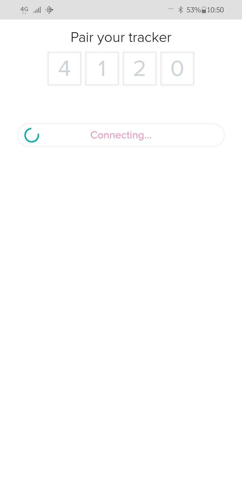

i'm not able to pair charge 2 with Asus zenfone 5z as i was having sync issue i have unpaired it but i not able to pair it again. charge 2 is giving me pair code but after its not pairing with fitbit application is stuck on pairing window.
i have been facing problems after upgrading it to 9.0

my last sync was on 26th March I tried to sync on 31st it didn't sync how many numbers of times I tried restarted phone cleared cash and the moment I unpaired it for pairing it again it's stuck on pairing window of which I have shared you the screenshot

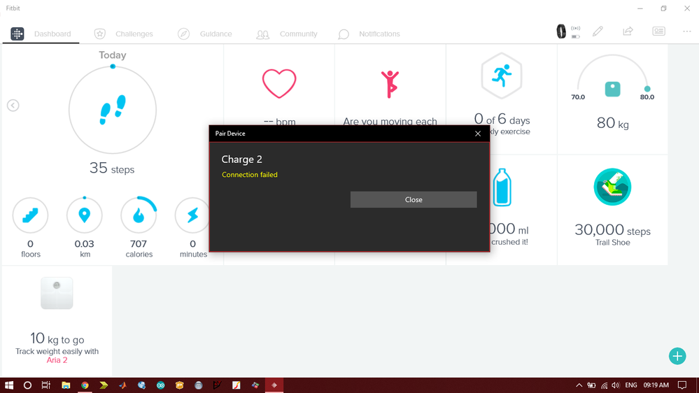

it does not work with my windows 10 laptop I have tried it.

As for Windows 10, it is possible that the Fitbit has bonded to your phone and this is preventing it from syncing to another Bluetooth device. If you have not, please try syncing to your laptop with the phone's Bluetooth turned off. It should let the Fitbit sync at that point.

it doesn't work with windows 10
1. I switched off phone Bluetooth and tried to pair with the laptop same error as described in the screenshot
2. I unpaired Charge 2 from my phone and try to setup from scratch with Windows 10 laptop. it was not able to find Charge 2 but the laptop is able to find other Bluetooth devices and connect.
when I was pairing Charge 2 there was no other device paired to the laptop.
Windows 10 in the laptop is up to date.
