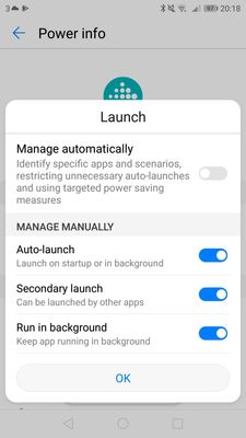

i have just got notifications running by turning off Manuel settings in phone system, App, Fitbit settings

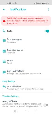

I have exactly same issue. Checked all settings, even done a factory reset and no joy!
I've had this watch since January, Notifications have never been up and running. I did a test call which worked. As mentioned above and illustrated in picture the app said restart phone to enable notivations. Never works.

do you mean this??
06-19-2020 15:38
06-19-2020 15:38
I could not find the setting I'm android phone.. Please elaborate the process
Thanks

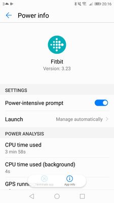

Best Answer06-19-2020 15:54
06-19-2020 15:54
Settings
Apps & Notifications
Apps
Fitbit
Battery
From this box I screenshot it.
06-19-2020 17:24

Welcome to the Fitbit Community, @MathewR @Girishohm. Thank you for your reply, @Moomin88.
@MathewR thank you for joining the thread and sharing the solution to the same issue you experienced. I appreciate your time and efforts, thank you for providing screenshots. I am sure this information will be helpful to other users.
@Girishohm I appreciate your participation in the Forums and hope you resolved the issue by following the steps provided in this thread.
@Moomin88 thank you for providing a screenshot. I appreciate your efforts and would like to confirm if you've tried the steps provided by @MathewR to resolve the issue?

06-25-2020 23:31
06-25-2020 23:31
Hi, yes touch wood it has worked (🤞) thanks very much everyone
