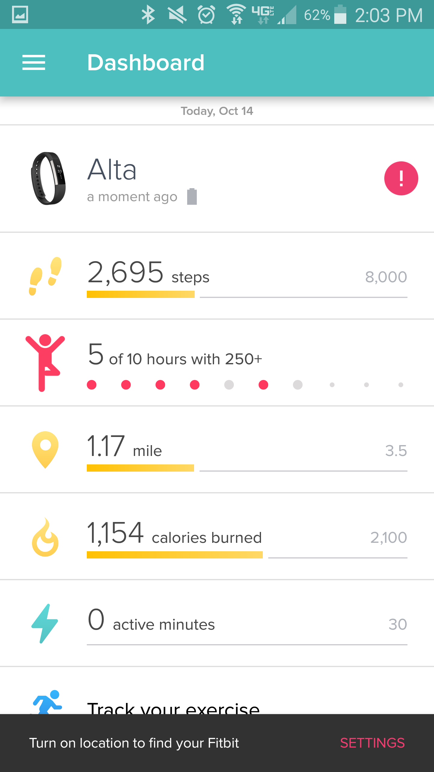

Is anyone else using Fitbit on their Andorid having the problem of a fast dying battery due to your phone constantly "finding location"? I noticed that my phone's battery was dying a lot lately, way sooner than it had been in the past. Around the same time I noticed this notification in my bar multiple times throughout the day, basically every single time I looked at my phone it was finding it's location. I decided to turn off my Location Services and now my battery lasts like it used to. The only thing I've done differently was buy/use my Fitbit. I can only come to the conclusion that it is from my Alta and how the app wants to locate it all the time. I don't even have it set to sync all day, just when I open the app.
I really want to be able to leave my location on but I just can't go throughout the day with my battery dying like it is.

Hello @dappledoxie,
Did you upgrade your phone to Android 6.0? If so, Google has changed their requirements where in order to communicate through bluetooth, you must enable location services. Fitbit is merely adhering to this new requirement to appropriately sync your tracker.
There's a post about it here.
I hope this helps.

There's a setting in the Fitbit App under your device for "All Day Sync", disable it and see if that helps.
If that doesn't work, then I would try to simply log out of the Fitbit App or turn off bluetooth when you don't need it to sync (though that would affect other devices as well).

Thank you for your response! Yeah, I've already got "All Day Sync" turned off. I will just keep my location off and turn it on when neeeded. The weird thing is that it will still sync my steps, sleep, etc when I open the app but it has the message at the bottom.
