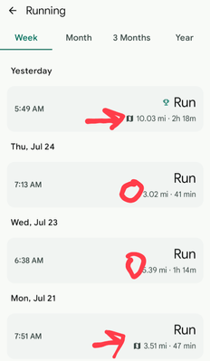

Hello - In the last month or so I've been experiencing an issue on my Pixel Watch 3 randomly deciding not to log GPS data with my run resulting in the Fitbit app not logging it as an exercise day despite the fact there is the entry of a run under a particular day with heart rate data, but that's all.
I'm also marathon training with friends and syncing my runs to Strava, but since there is no GPS data, it's not showing up there either! The issue is exactly the same as this one reported last month in June:
Like the user on this thread, I'm not doing anything differently on Wed/Thu as I did on Monday, but only Monday had GPS data. I am doing a big run tomorrow and will test it today if I can post-reboot to ensure it's working again.
In the watch under System --> System Updates, my watch says it's "up to date" on version 15 with the security update from June 5, 2025. From the app, build is BW1A.250605.004. The thread above mentioned a pending update possibly - has that been released? If so, is there a way to force my watch to pull it? I don't see a "check for updates" button in the watch or app.
The same issue occurred for me as well back in June, and I did a manual power down of the watch and restarted, and that seemed to clear it up, but it has returned this week and cost me two runs of data. This is not acceptable while I'm in training, and after years of loyalty, I'm really wondering if I should consider switching to Garmin which I don't want to do, despite the fact the battery life on this watch leaves a lot to be desired compared to the Sense line I used to have.
This has happened to me twice now, so I'd really like to get this resolved if possible. As the other user(s) reported in the other post, when you're in the run, the metrics look the same, though I did see it say "connecting to GPS" multiple times when I had open views of the sky on similar routes where it's usually not a problem - so seems to be a bug of some sort. At that point though, you've already lost the data, and unless you're willing to STOP your run, reboot the watch etc. you're out of luck which is not conducive to my training plan and defeats the whole purpose of why I bought this watch!

Thanks for helping troubleshoot - I was able to log ten (10) miles yesterday (Saturday) with no tracking issues and the sync over to Strava as expected with map / GPS data after a manual shutdown then restart on Thursday - so something is clearly up with the watch, but you don't know it's an issue until AFTER you've lost a run (or more)'s worth of data, which obviously isn't ideal.
The problem is this appears to be random when it occurs, but I'm hoping Google/Fitbit support has a fix in the works - I can also open a ticket and point to this post if it will help, provide logs etc. as I am able.
