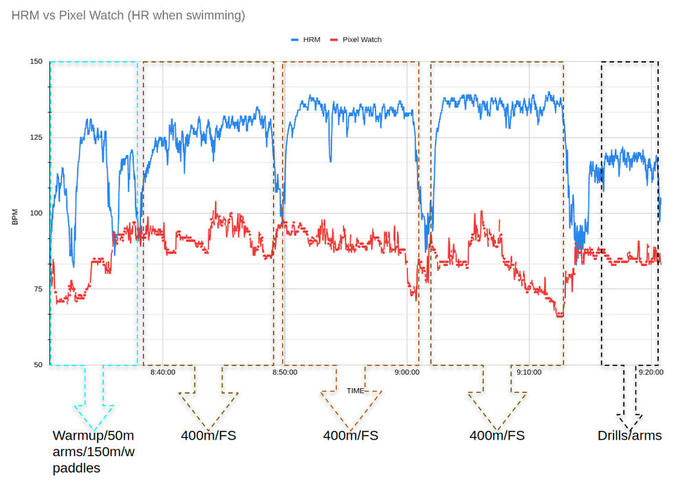

@TaoDoggy I don't own Pixel Watch but had a chance today to use one and it only confirms my theory that HR won't really be "perfect" and not even close to accurate (I tracked it as generic workout):
Pixel Watch tracked my HR way lower than the HR monitor and, as you can see, it does not correspond with intervals of my workout. Even if you wear (any) watch tight it will still let water under the sensor due to the pressure (imagine that any swim watch can break under the water pressure so snug/tight fit is not an obstacle for moving water). Pixel Watch has some holes in the data when the sensor couldn't read HR at all. I can get a comparison for my Garmin watch using its optical sensor (I can use two sensors and afterwards I can override wrist OHR with HRM data) and that will be better but not good enough. The best optical sensor I've seen that works in the water is Polar Verity Sense but it's more powerful (high sampling frequency, very bright 6 LED lights) and must be worn on goggles (ideally, goggles under a swimming cap and covering the sensor). This gives quite decent results (but there are caveats).

@t.parker Thank you very much for your input and explanation. I really appreciate you taking the time to show the results of your training. That should be the reason then, that heart rate measurement is not available for swimming sessions. This will surely help other users with the same doubts. Thanks again!

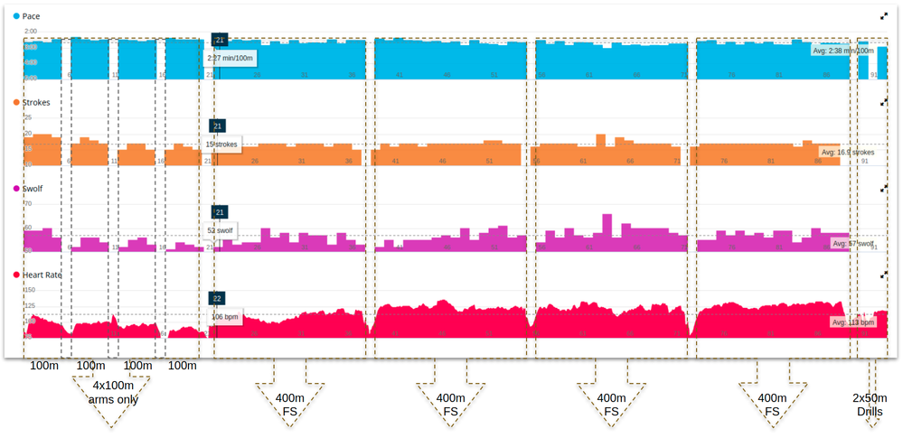

@RodrigoMFitbit that isn't exactly true. Most of the watches indeed don't bother with tracking HR as it requires some updates of algorithms and, in some cases - hardware. However, giving the option to turn on HR while swimming wouldn't hurt anyone considering showing a disclaimer informing about lower accuracy. Said that today I forgot my chest strap and had to rely on my wrist HR. As much as I don't think it's 100% accurate when it comes to swimming I take that into account and look more at trends of HR rather than absolute values. If you look at my today's workout breakdown using the wrist HR of a dedicated watch (some dedicated improvements for HR reading in the water):
You can see that trends are matching pretty well. Each interval can be seen. I'm quite sure that the 400m intervals would be a lot smoother at the top if I used a chest strap but this output is acceptable for me as a swimmer. There is still a cost I mentioned before - it ate 10% of my battery within a 1-hour workout. This is more than GPS eats (GPS on that watch is 3%-4% per hour). So as an "emergency," I do use optical HR, just not on Fitbit because I'm not being given a choice. This happens maybe once every few months as usually I keep my swimming chest strap in my swim bag 🙂 What I'm trying to say is nice to have a fallback (and choice even if it means shooting your own foot).
