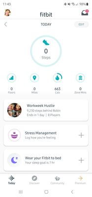

My Fitbit tile (main goal) on my Pixel watch is showing zero always. This started only a couple of days ago and before that it was working fine. Once I click the tile and go in to the app for details, steps are shown correctly. But in the main tile on the Pixel watch, steps are always shown as zero. Can anyone help? Any moderators who can help with the question above? Thank you in advance!

I am not the original poster - but I am having the same issue. I got a new phone yesterday (S23 Ultra), it appeared that the watch would not connect to my new phone. From what I read online - it sounded like you unfortunately need to factory reset the Pixel Watch to connect to a new device. After my factory reset - I was then able to get my phone and watch connected and received notifications on watch. But realizing this morning that now my steps and sleep are not being detected. I updated all apps on the watch, but not sure what else to do?

If you keep having this inconvenience with your Pixel Watch, please attach an screenshot of the step tile on the Fitbit app and a picture of your watch showing the step tile too.
