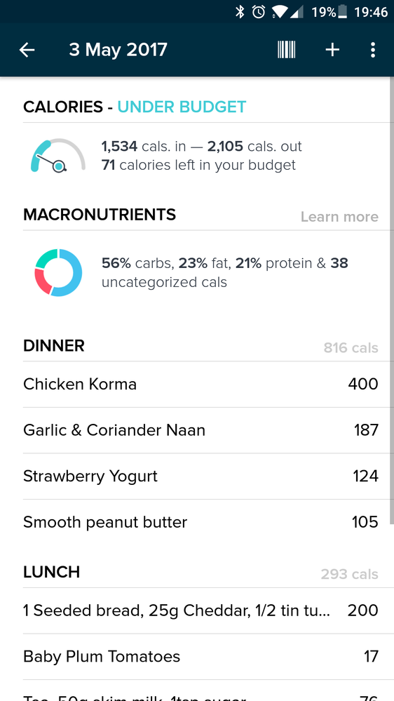

So I've been creating foods for meals etc. that I make, basically adding together all the things I put into the meal and entering all of the nutritional information based on this sum. However I keep getting random amounts of uncategorised calories. For example I'll add a food I've created that's about 500 calories and fitbit tells me I've got 32 uncategorised calories. I've filled in all the nutritional info, and I'm super confused about why i have uncategorised calories and why it's only a fraction of the food item I've logged...

Hi there @Aisharebecca, thank you for providing me more details. Thank you for providing me the screenshot of your food entries. I see what you mean with categorized calories.
Note that the new Macronutrients feature is a simplified view of the Carbs, Fat and protein. Although when the food you logged does not contain only those three categories the macronutrient feature will label those calories as "Uncategorized Cals"

No I'm not using quick calories, as I said I've created a food and entered all of the nutritional info but when I add it to my food for the day it gives me some uncategorised but most confusingly not for the whole thing.
This was an example, I've added other food since but I initially added 'Chicken Korma' as a custom food which I make at home, worked out all the nutrition and entered the values and added it on this day. The 400 calories were added and 38 of them were uncategorised. I'm not sure how it's only a fraction that's uncategorised and annoying when I spent time working out my homemade meal so I could have it be accurate.

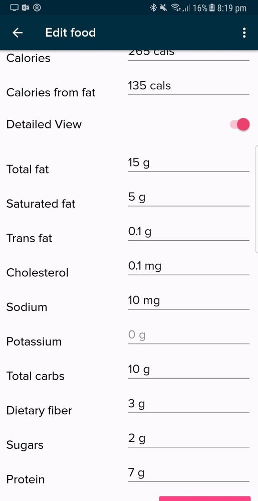

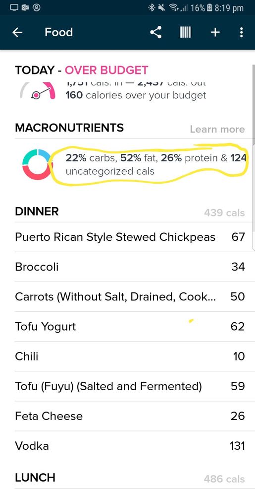

I am having the same issue. Here is my working theory: I think this is happening because the calories based on the macros don't add up to the total calories for this entry:
total calories: 265
macros:
fat = 15g * 9cal/gram =135 cal
carb = 10g * 4cal/gram = 40 cal
protein = 7g * 4cal/gram = 28 cal
total based on macros: 223 cal
So fitbit takes the 265 - 223 and finds that there are 42 calories unaccounted for. I see you have more uncategorized cals than that, are there more foods with unaccounted for calories?

@lrnvl it's very much like it. When I add foods to MyFitnessPal by getting data from the labels, MFP automatically calculates calories based on macros and then I need to manually correct calories if I want it to match the label. So I'd say the food labels are here to blame.
