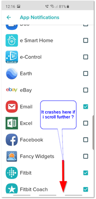

One app in particular was causing the crashing (in my case it was GYMKY). To find out which app is causing the crash do the following:
1. Open the notifications app list and slowly scroll down to the last app BEFORE it crashes (I'll be using op's screenshots here):
So in their case, it crashed after "Fitbit Coach"
2. Now open your apps in your android phone in the settings (wherever they are on your specific phone model); sort alphabetically if this is not the standard sorting method
3. Scroll down until you see the app that you found was the last one before the crash (in their case "Fitbit Coach") - now uninstall the app that comes right AFTER that app.
Now the notification app list scrolling should work again in your fitbit app (at least it did for me).
