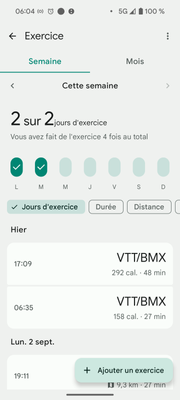

Hello,
A little everywhere it is indicated to modify the length of the step to correct the problem of distance traveled which is not any more gone up in Fitbit ☹️.
I was told to follow this menu:
But there's no such thing as changing stride length in the settings menu! 🤔
Thank you in advance for your help.

Hello, thank you for your reply.
But when, on Fitbit app, I press the 3 dots at the top right of the Exercise page, I get the menu shown on the second screenshot below (Santé Connect)

Hello @2Flo9
Is that the only option you see when you tap on the 3 vertical dots? My app shows Activity settings and Manage data.
There is another way to get to the Activity settings:

Merci pour votre intérêt porté au problème.
Oui c'est la seule possibilité. J'ai exclusivement l'ouverture de cette page Santé Connect. Je n'ai pas le choix des menus que vous évoquez
Je vais regarder par l'autre possibilité que vous donnez.
