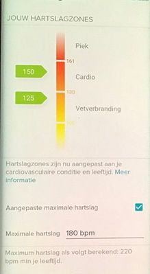

but how can you explain this.
My RHR = 55
I set my max to 167. Nothing changes.
after some calculations my max should be 180.
So I have a body of a 40 year old. 😁
Not so bad.
Calc:
105 (fatburn) - 55 = 50 = 40% of reserve, so 50/40% = 125, so max = 55 + 125 = 180. Or
130 (cardio) - 55 = 75 = 60% of reserve, so 75/60% = 125 etc Or
161 (Peak) - 55 = 106 = 85% Etc.

@SteveH the problem is gone. Now it’s working as it should.
