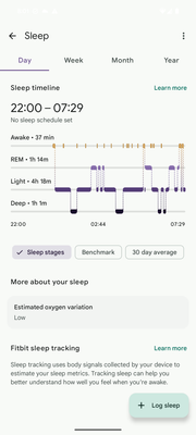

*Photo with correct sleep times.

Also, you mentioned it not tracking your first hour of sleep. That happens sometimes, if you wake up during that hour, especially if you get up and start moving around. Your Watch uses motion and heart rate patterns to detect that you are sleeping. It takes an hour to do that. If you edit that start time of your sleep and sync a couple of times, you should get some data for that hour. Here's the graph for a night that I had to do that and you can see that the data for that first hour is not very meaningful. My watch really didn't know what was going on during that hour.

Yes Jonny I've heard what you've said. I'm trying to capture from when I go to bed, not letting Fitbit decide when it thinks I'm asleep.
Last night I was in bed @ 2200. It doesn't start tracking untill 0008. I was awake at 2330 and sent a few texts.
I would like to know before I woke up what it thinks I was doing is all I'm asking. Not being at the mercy of it deciding I'm now asleep. I was asleep shortly after going to bed at 2200.
 Thanks again for your help. It seems this isn't how the watch works.
