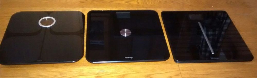

I have three scales, the Aria and two similar scales from Withings:
Yes, you can call me a smartscale freak
I step on each of them every morning. The Aria always sees me heavier than both Withings (which give me the same weight), always by 0.4-0.5 kg. It also always sees me slightly fatter, by 0.5-1.0%. Based on these observations, I would say the Aria is less accurate (in absolute terms), but the difference with the other scales is minimal and always in the same direction.
Looks like with the Aria, YMMV. I purchased mine in June 2013, btw.
