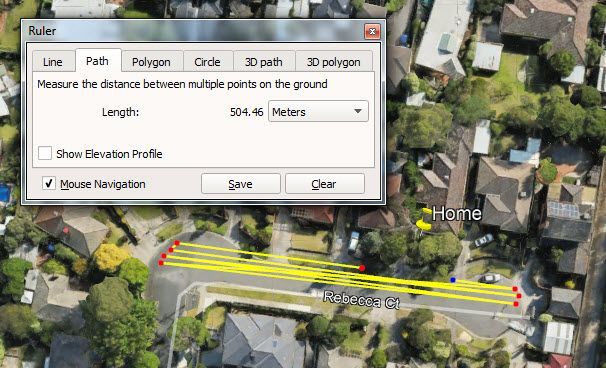

@hatzinikolaou I just did a small test using MapMyRun and the Ionic.... At the end I compared it to Google Earth and only 4m different over 511 metres and MapMyRun.. My court goes E/W and the stretch is 90m straight with a 5m incline which you can see on the graphs. Also MapMyRun which had very brief pauses.. Satellite dropout. Over the last few weeks I had been blaming my phone using the Blaze and the App but the same thing happened on Ionic which confirmed it was satellite and not my phone.
Pace was consistent with the elapsed time 4.7 to 5km/hr and it took me about 25m to have the satellite connect, even though my GPS Status App showed immediate connection. When it connected I pushed the button and then finished when I hit 0.5km, hence the parting of the start and stop points.
The plotting of the graph is accurate but skewed slightly to the left.
