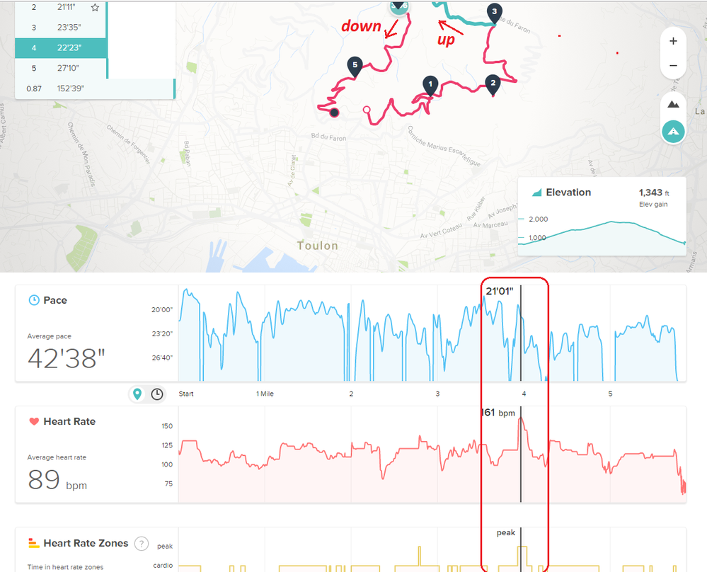

I'm seeing wrong readings at times too. It seems in particular that as I hike downhill, the Blaze can sometimes more or less double my heart rate. it was between 100 and 125 as I was going uphilll and then there was a sustained peak at 161 as I started walking downhill, when it most likely was around 80. It may be the acceleration changes associated with walking downhill (more impact than walking uphill) in some conditions can cause incorrect readings.
Actually, it might be that if the frequency of the steps matches the heart rate, the FitBit sees extra peaks it interprets as heartbeats. I've seen this before, and I think I've seen it as well with the Surge I had before the Blaze, Need more smarts in the algorithms... Picture of the hike profiles below..
