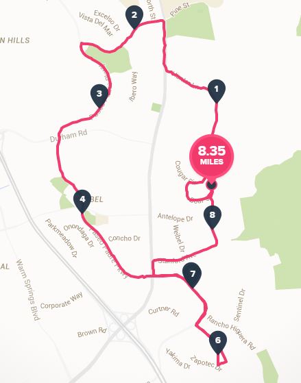

See 2 maps below. The top was captured from my Samsung Galaxy phone using Mapmyrun app. The bottom was from Fitbit using Connected GPS mode with the phone. The phone was on my right arm and the fitbit on my left wrist (implying that both were within 2 feet of each other).
The Fitbit app tracked the map pretty accurately until mile 6 (see picture below), then it went haywire, then reconnected somewhere between mile 6 and 7 and stayed connected for the rest of the run.
During my run, I had no way of knowing that Fitbit had disconnected and reconnected, and all I could see was that the distance indicated by Fitbit and Phone was off.
This behavior has happened more than once, so it is very annoying.
Let me know if anyone needs more details.
