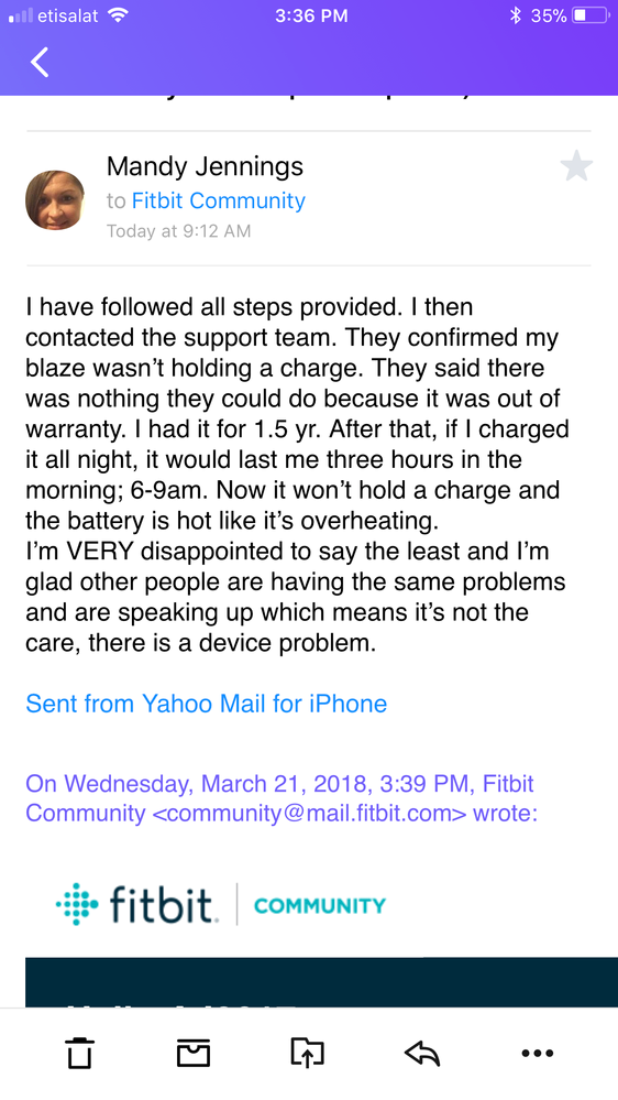

I have the same problem that just started yesterday. I’ve had my Blaze for almost 2 years and I’m not prepared to buy a new one. I use it daily and it’s been able to hold a charge for 4-5 days and it was fine. I’ve reset the Blaze, it charges and then after about 4 hours, it drains. Can I get any help?

My Blaze lost power initially one day after a brief submersion after falling off a paddleboard. I wiped the contacts and enclosed it in a bag of dessicant in case it had moisture in it. A full charge then lasted only 4-5 hours. I repeated the process twice more with the same results. After a couple of weeks of overnight charging, I'm stuck with a 3 month old "sports performance watch" that can't stay awake as long as this 62 yr old man stays active in a day. Not much of a testimonial for FITBIT!

I have the same issue and the battery was lasting about 3 hours. I ended up replacing the battery because mine is out of warranty anyway but the battery life was the same with the new battery. So, that told me there was another issue. I charged it and left it on the dresser over night and the battery was still good in the morning...ah ha. Heartrate monitor is on auto mode which meant it wasn’t running during the night. I turned off the heartrate monitor and now my battery is not going dead. There is obviously an issue with my heartrate monitor. I am wondering if this is the issue with other people’s Blaze battery drains. Try this and let me know. If it is it’s a defective part and is pretty much useless to me cause the heartrate monitor is why I purchased this.
