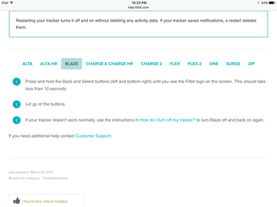

So sorry to hear this @HB2!! Try restarting it 2 or three times. If that does not work, contact Support.

You can still,go thru the steps in the instructions with a dead Blaze. Be sure to do it 2 to 3 times.

With the blaze some have been successful getting there unit working by pressimg the buttons while the tracker is in its charger charging with the lid open
