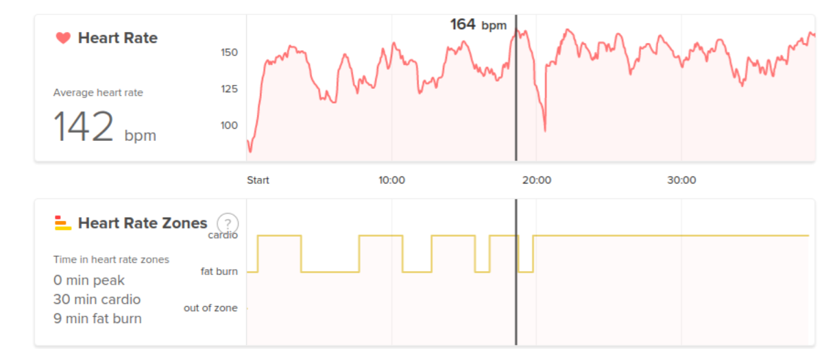

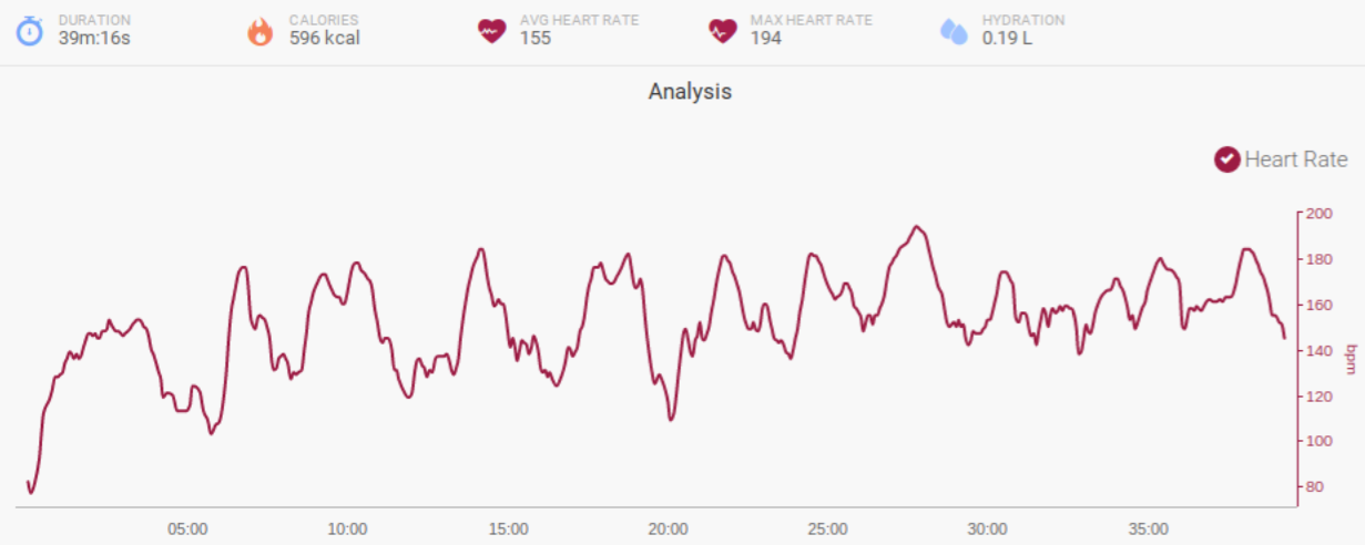

I tested the Blaze vs the H7 today at the gym. I used Endomondo for the H7 and the Fitbit app (of course) for the Blaze. I started the exercises simultaneously and used aerobic and anaerobic movements. If you have any questions, please feel free to ask. If you would like me to test other workouts, please feel free to ask. I will be happy to help you make an informed buying or returning decision. What did I do? Tread mill, jump rope (moderate and intense; regular skipping and double unders at roughly 30 second intervals), back rows  (machine and free weights), lateral raises (dumbbells), push ups. I consistently checked the Blaze against the Endomondo app with H7 monitoring.
Review/Thoughts
The Blaze does an exceptional job tracking heart rate for exercises under ~155 beats (it does *rarely* have a spiked drop here and there, but generally it is right on). Once the heart rate goes above that, it is hard to know if it is accurate (which it sometimes was) or is hardly accurate (which it sometimes was). The conditions that gave me different results were the same: jumping rope. With regard to the weights, I did not have trouble with the device. It was within  approx. 5 beats of the chest strap. I believe the discrepancy while skipping rope comes from the Blaze's inability to quickly track a a pulse once it reaches the anaerobic zone. The sensor on the Blaze records your pulse every second and scans it many more times than that per second; however, it doesn't do a great job once your heart react reaches the 150s and up. Interestingly enough, Fitbit describes the peak zone at about 152... and that is right about where the device starts to lose credibility. A few times-I stress a few- it did keep up with the chest strap and go into the 160s, but there were many times when my heart rate was at 180+ and the Blaze was nowhere to be found (it was in the 150s).
Conclusion
Just like you'd expect, the Blaze doesn't do great with extremely intense exercises. However, if you are doing moderately intense to intense workouts, you can count on it to be pretty spot on, and I mean very, very close!!!! Below are the graphs of the workout. With that said, your calorie count is definitely going to be thrown off because the Blaze is less likely to put you in the anaerobic zone. Blaze had me at 473 while the H7 on Endomondo had me at 596.The top is the chest strap (with endomondo), and the bottom is the Blaze.

The large spikes come from jumping rope inbetween my lifting sets. I really pushed the device to where it's most limited, and it did a decent job. It will do very, very well at tracking your heart rate throughout the day and for your moderately intense workouts!

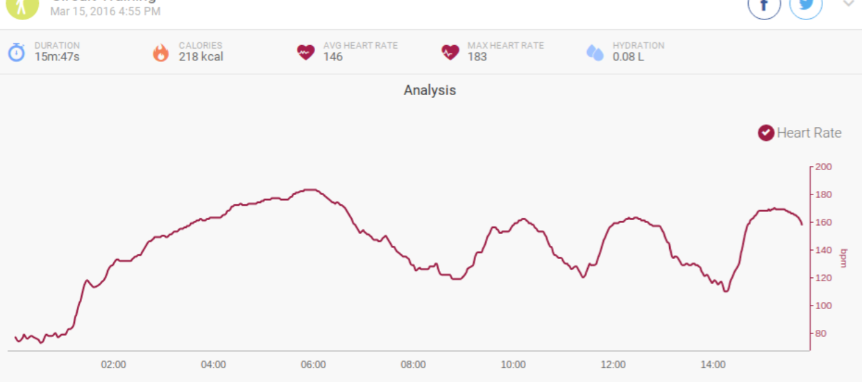

RETEST DAY 2; Different results:Smiley Very Happy
Differences- I moved the monitor up about an inch on the arm.
I did a gradually increasing cardio workout to get my heart rate into the 180s. The Blaze performed phenomenally. Moving the Blaze up some also  made a difference in the HIIT with the jump rope. Instead of being off by 20+ beats at times, the Blaze with always within 10 beats. There is still room for improvement, but this device performs VERY WELL  for a wrist-based monitor. Once again, it had NO problem keeping up with weightlifting/ body exercises. Graphs below:
Conclusion:
Arm placement makes a big difference... Also, the Blaze still undercounts the rapidly rising pulse, but it got right near it every time. There were instances when I thought that the Blaze was using the heart rate monitor to get its information; it was seriously spot on, and I was trying to mess it up... So I am going to leave my previous review up (so people can see the difference in placement), but this one is going to be my final take on it. The Blaze gets an A for accuracy...

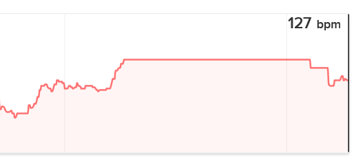

Also, today I noticed the Blaze just gave up and flat lined my HR. Again, no help at all. But, I acknowledge that the training I'm doing is not what the Blaze is for and so have the chest strap. But I do have the Blaze for the rest of the day, and I'm happy with what it does there.
