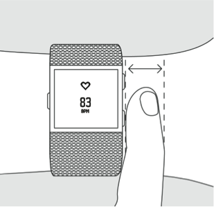

When using your Fitbit Blaze, it takes your heart rate into consideration mostly to provide calories burned information. This means  that wearing it properly has an impact on the results you will get. For this, for all-day wear when you’re not exercising, your tracker should usually rest a finger’s width below your wrist bone and lay flat, just as you would wear a watch. Fitbit’s PurePulse™ heart rate tracking system is designed to be most accurate when the tracker is worn on the top of your wrist as shown below:
