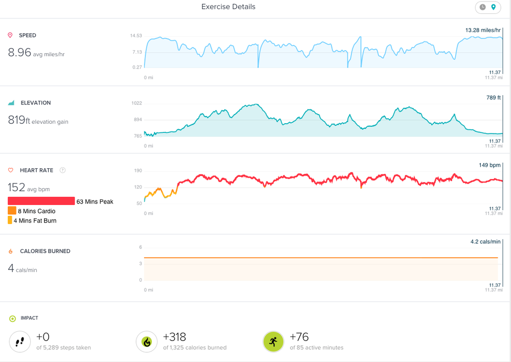

Lately my mountain biking sessions don't seem to be calculating calories correctly.  I just finished a 1:16 ride, fairly strenuous and it calculated 318 calories, see below.  My strava record for the same ride shows something like 650-700 calories, which feels closer to accurate.  Strangely, my running sessions seem to calculate calories more accurately (approx 100 cals per mile at my height/weight).  But biking is off.  Any ideas?  Notice the calories burned per minute is flat-lined, even though my HR fluctuates.  Doesn't seem to make sense.  A setting somewhere?

Thanks for responding!  I am just selecting Bike on my Blaze and then going for a ride.  It gets the HR, elevation, etc, correct, just doesn't seem to be trying to calculate calories.
Went biking today again and a strange thing happened.  I recording my ride by choosing bike on my Blaze.  Right when I finished I synched and the results showed something like 11xx calories, and the calorie burn per minute fluctuated during the ride.  Then I checked again later and it change the calories to 4xx and flatlined the calories burned per minute.  It's kind of like the phone app calculates it correctly then the server overrides it with a flatline calculation of 4 calories per minute regardless of the HR or other factors.  Strange.

Same issue here with workaround below. Biking using the phone or Versa 2 via Fitbit gives me a flatline for calories. For example today was a short ride 3 miles 1,000 foot elevation gain and loss and strava tracks 700 calories (using wahoo heart rate monitor and other sensors) while fit bit tracked 200. Happens every time I have biking tracked via Fitbit. Other activities track correctly.
****WORKAROUND****
delete the tracked bike ride from the app. Then it tracks the calories correctly.
