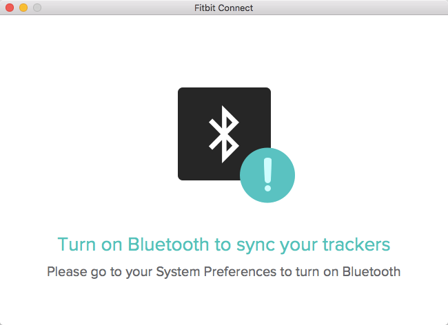

I have a new Blaze and I cannot finish setup as I am unable to update the firmware. My android app fails to update almost immediately, while my Mac software tells me I need to turn on bluetooth, which is already on. Can I update it via USB?

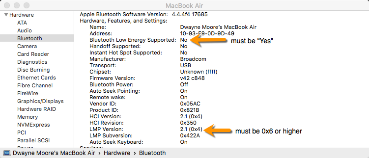

The Fitbit Connect software for Mac has a bug in that on older Macs that do not support Bluetooth 4.0 LE, it gives a message that Bluetooth is not turned on instead of an error with useful information.
You can check whether or not your Mac supports Bluetooth 4.0 LE by looking at the Bluetooth section of the System Information.
"Bluetooth Low Energy Supported" will be "Yes" and "LMP Version" will be 0x6 (or higher) if your Mac supports Bluetooth 4.0 LE.
If your Mac does not support Bluetooth 4.0 LE you will need the Wireless sync dongle that Fitbit used to include with its trackers, but stopped including with its newest trackers.  From the posts of others in these forums it appears that one can contact support and they will send you this dongle for free.
