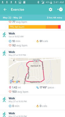

@Rich_Laue, Thanks. The first time, I had the app open to 'Exercise' and 'Tracking' but did not press start...just wanted to see that GPS was locked on. I then made sure the tracker was connected...got the 'Lets Go' and pressed start on the tracker. Never touched the phone again, just had it in my pocket. Afterward, I was able to see my stats on the tracker but no map in the app.
I tried this again without the app open on the phone. Even turned off GPS on the tracker afterward but still no map shows in the app. I've already tried resetting the Blaze and have tried multiple walks but it never maps.
