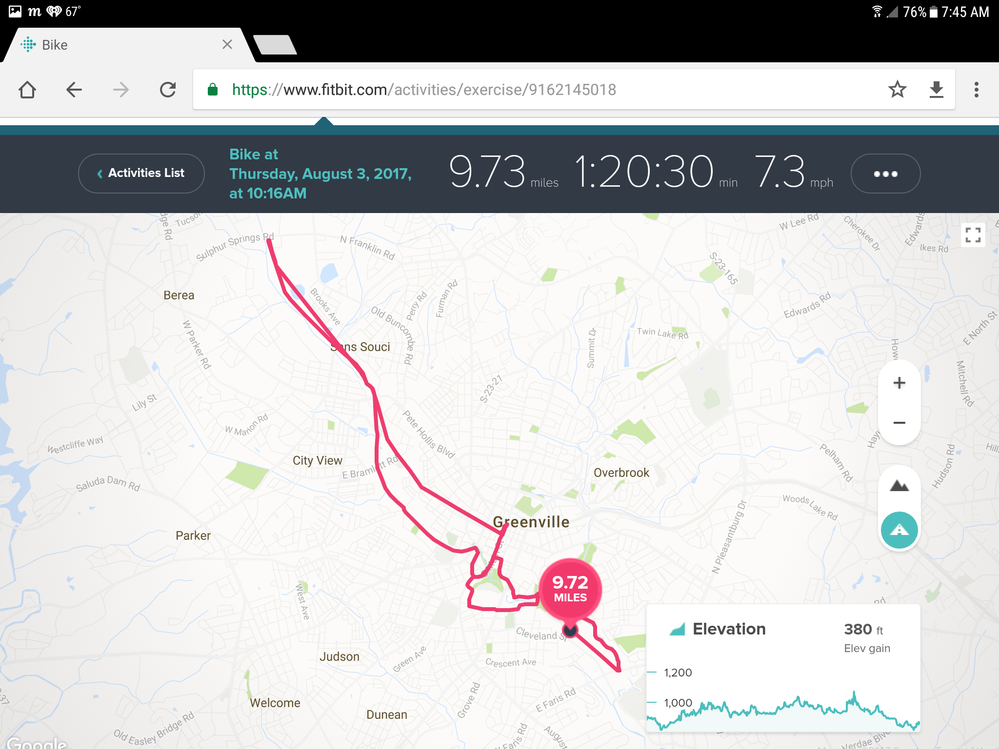

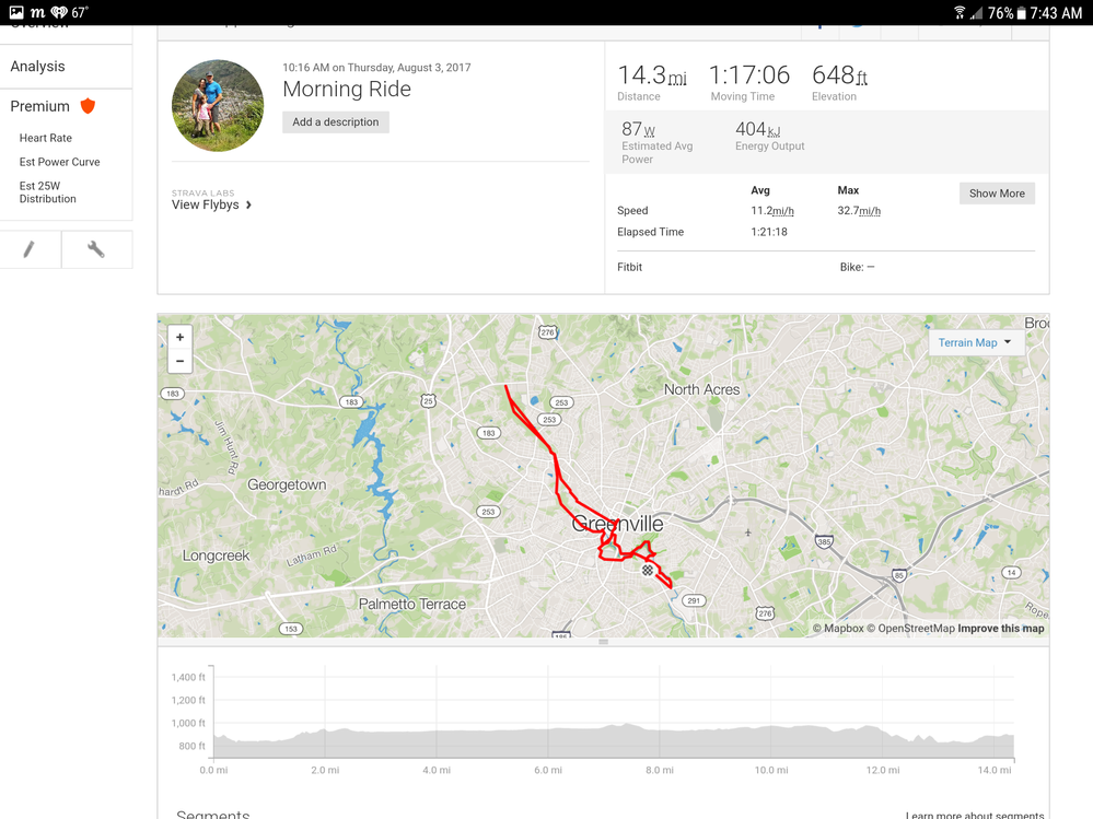

Same issue yesterday.  Started bike ride on blaze.  Have it synced also to Strava.  I know my ride was about 14 miles.  Looked at fit bit as nd it said 9.5 miles?  Strava correctly said 14. Same issue during running. So the raw data being sent from fit bit to Strava is correct but calculated wrong by fit bit. This is not good.  I like fit bit but will have to just use the blaze as a daily fitness driver and watch and pull out my old moto 360 sport for GPS tracking.  This is very dissapointing.  Fitbit needs to investigate this and fix it since I know the raw data is correct.
This is just more evidence that the calculation is wrong! Sadly for those of us who want relatively accurate data, we can't rely on it. I could not recommend the Blaze for tracking GPS activities.

Yes.  That is what I stated in previous post.  I have fitbit linked to Strava so fitbit is sending data to Strava.  Strava shows the actual distance correctly with the raw data it receives as I have done this ride before and know it should be around 14 miles.  Strava is also more correct as far as elevation gain.  This behavior appears if starting exercise from the blaze and if road cycling at higher speeds.  This issue does not seem to be as bad with slower pace mountain biking started on the phone and calling it a run since biking is not an option in the app itself on ios.  Therefore the raw data is correct but something is happening in how fitbit looks and interprets this data.Screenshot_20170807-074332.pngScreenshot_20170807-074521.png

Yes.  That is what I am seeing.  Correct if started on phone.  Incorrect sometimes (don't know how often would have to go back and look) if started on Blaze.  The point of having the Blaze is to control your GPS runs or cycling on the Blaze, not continue to use the phone.  Don't want to have to pull out the phone during a ride
