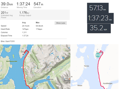

Strava(left) vs Fitbit(right)
On the last ride the difference is 1.6 with coinsidently is the differense between 1mile and 1km...maybe theres something wrong with the metric mode on the fitbit?
2 last rided tracked by Fitbit Blaze /w Phone GPS ,synced to Strava.
Fitbit: 37,35km Distance, 1.42.05 Time, Avg Speed 22km/h
Strava: 23,2km Distance,1.35.06 Moving Time ,Avg Speed 14,7 km/h
Fitbit: 57.12km ,1.37.23 Time, Avg Speed 35,2 km/h
Strava: 39km, 1:37.24 Moving Time, Avg Speed 24,1 km/h

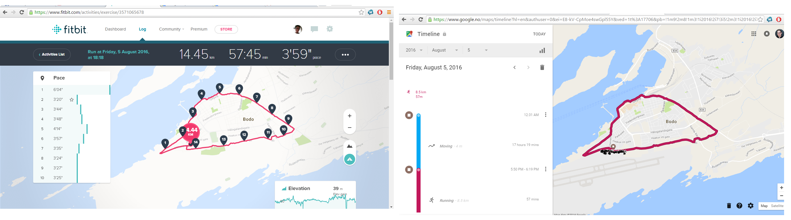

I would like to apply this post also here even tho i did it on another topic.

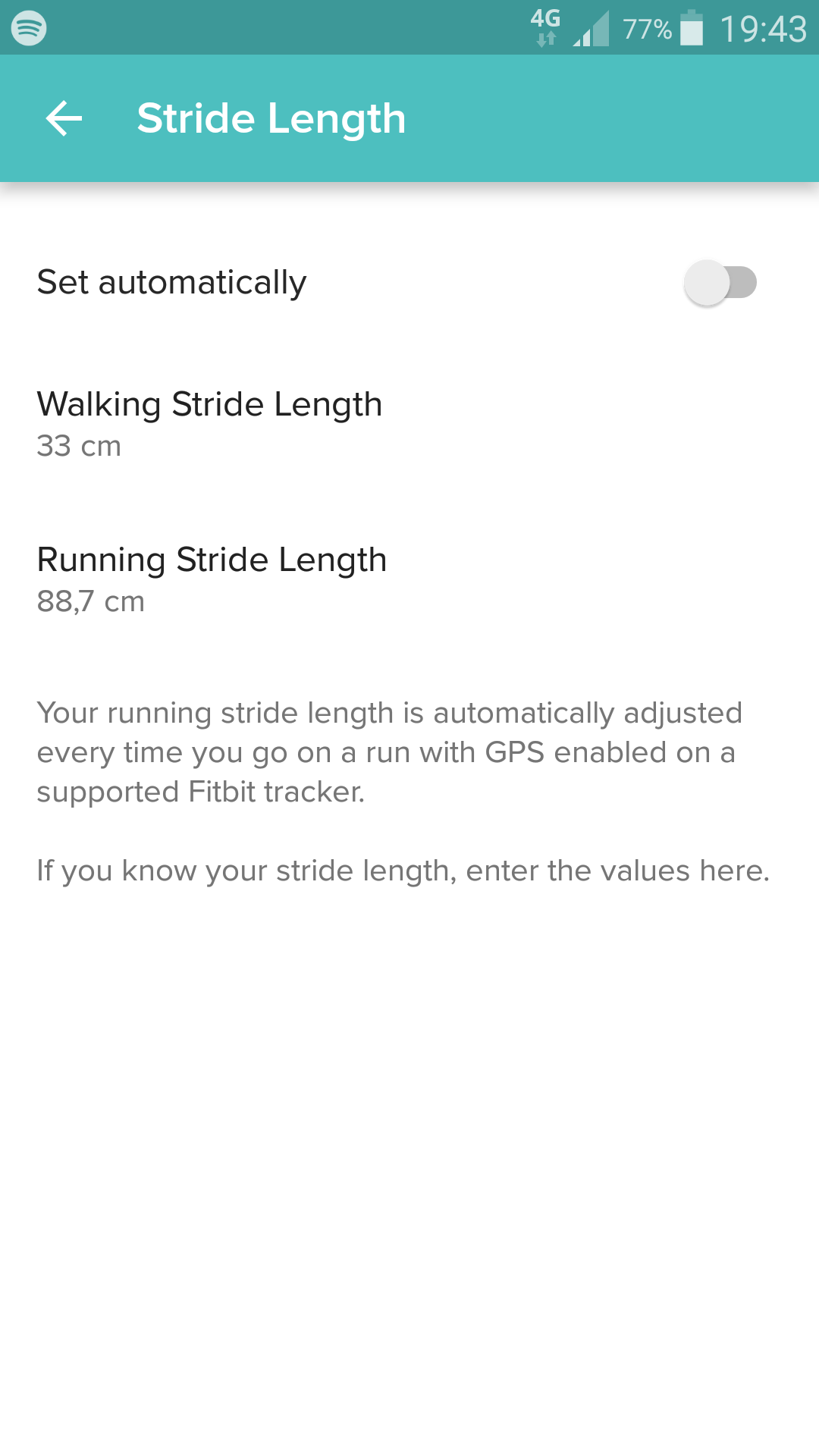

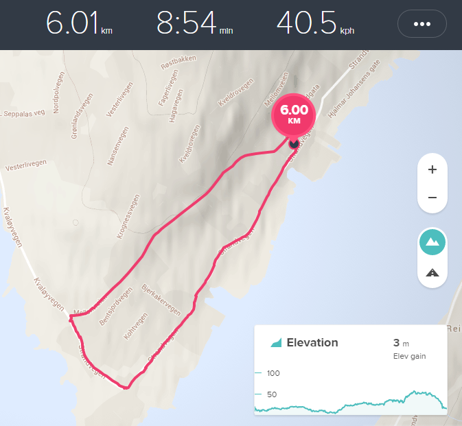

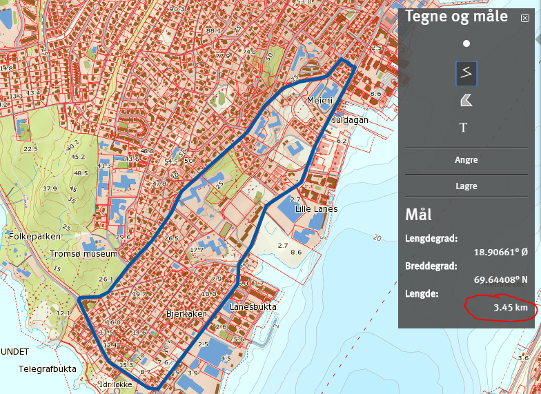

Since the Blaze is useless with pair GPS on the mather of distance i was thinking of doing a test this time. I compared the actuel GPS distance data from google map log and took my previus runs and made an average stride lenght to see if the distance would give me more acurate lenght.
As seen on the photo under i undid the automatic stride lengt option.
I then had a run as seen under. But tho, still same problem. it has 5,95 km over the actuel lenght.
WTF fitbit do suck.

Easiest way to test this(if you don't sync to strava or similar) is to use http://www.mygpsfiles.com/app/ ,just download your tcx file from fitbit and upload them to mygpsfiles.
The funny thing is that the GPS data is correct ,upload them to any other application(strava ,runkeeper ,mygpsfiles) and the data tracked by fitbit is correct ,but the data it displays is very wrong.
Since these are tracked in "bike mode" so stride lenght does not come into play. Steps are not tracked in bike mode. So it must be somthing with the GPS Data.
