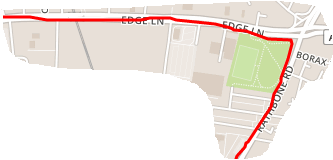

The map cuts across random land, doesn't follow roads at all and just generally makes no sense. I got a reply from support last night and they have suggested that high buildings or my phone's wi-fi might interfere but I run in a rural town in Suffolk, UK - there would be little or no wi-fi that could interfere and certainly no tall buildings.

I understand the Blaze doesn't have a GPS of its own and uses the one on your phone (as support were keen to point out to me) but if other apps running at the same time can track accurately that doesn't explain the Fitbit inaccuracies.
Here, the line is so far out it's cut across a wasteland, train line and a river when I actually followed a road at the top right of the map then the one above the small pond. I then crossed over the main road and followed the smaller road along the grey area bottom left, which isn't where the Blaze goes at all:
