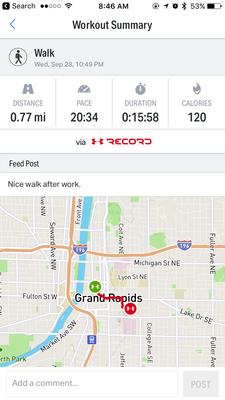

@Corvettekid I didn't walk a 1/4 mile, but I tracked my after work walk with both the Blaze (connected to phone Gps) and UA Record. Below are the screenshots.
Fitbit
UA
.03 of a mile isn't a big difference.
